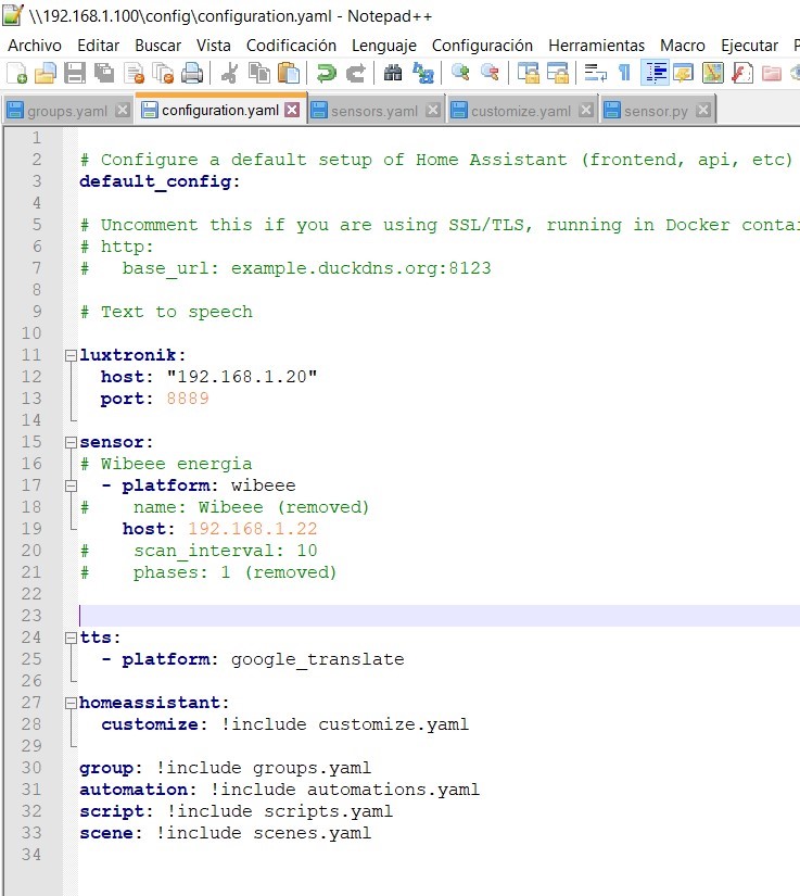

I have news. I have updated the firmware of the heat pump and now I have ports 8214/8888/8889 open and I can read data and give stop/start commands by connecting through a web browser with the IP 192.168.1.20, once inside if I use the password 009445 I change to install mode and I can modify many more parameters.
  • I am totally new to this subject so I may not have configured homeassistant correctly. I downloaded the files here: https://github.com/Bouni/Home-Assistant-Luxtronik
  • I pasted the luxtronik folder into custom_components
  • I have added to the files configuration.yaml, sensors.yaml and binary_sensors.yaml the indicated text.
I restart home assistant but it doesn’t detect any new components/sensors.
config2 config3
OK @dmartinezs, we’re almost there :smiley:
  1. you said that you have created the .yaml files for sensors, binary_sensors, etc. You’ll need to configure the configuration.yaml file accordingly, so that homeassistant knows where to find those. In consequence, all entries of the same domain (e.g. sensor) must be moved to the declared file outside of the configuration.yaml file. Have a look here: https://www.home-assistant.io/docs/configuration/splitting_configuration/
  2. have a closer look at your indentation within these newly created .yaml-files. Especially the binary_sensors.yaml would need to look like this:
