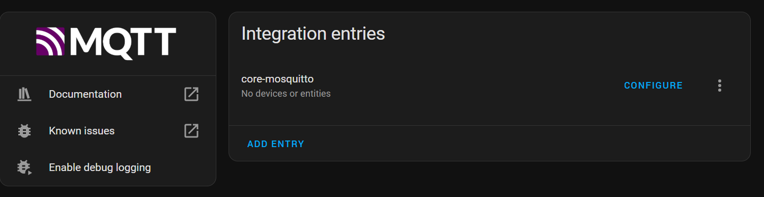

After that I’ve installed the MQTT - Home Assistant Integration and set it up as ‘Use the official Mosquitto Mqtt Broker add-on.’
What should I do next so this add-on can find my media player because I see ‘No devices or entries’ at the moment.

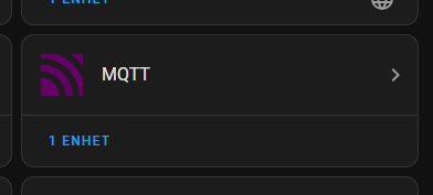

If you go into the log of the mqtt you should see some data:

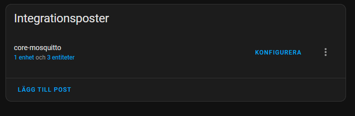

You should have the MQTT addon like this:
{B4EF69E5-37BC-45CB-AD2F-832542D07AC0}

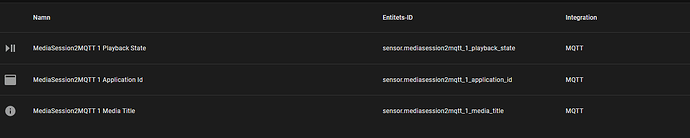

if you open it up you should have 3 entities:
You can use the above enteties for automation and so on
All I see is ‘No devices or entries’. Is there something I should change in the app settings on my media player? Is it required to set a user/password?

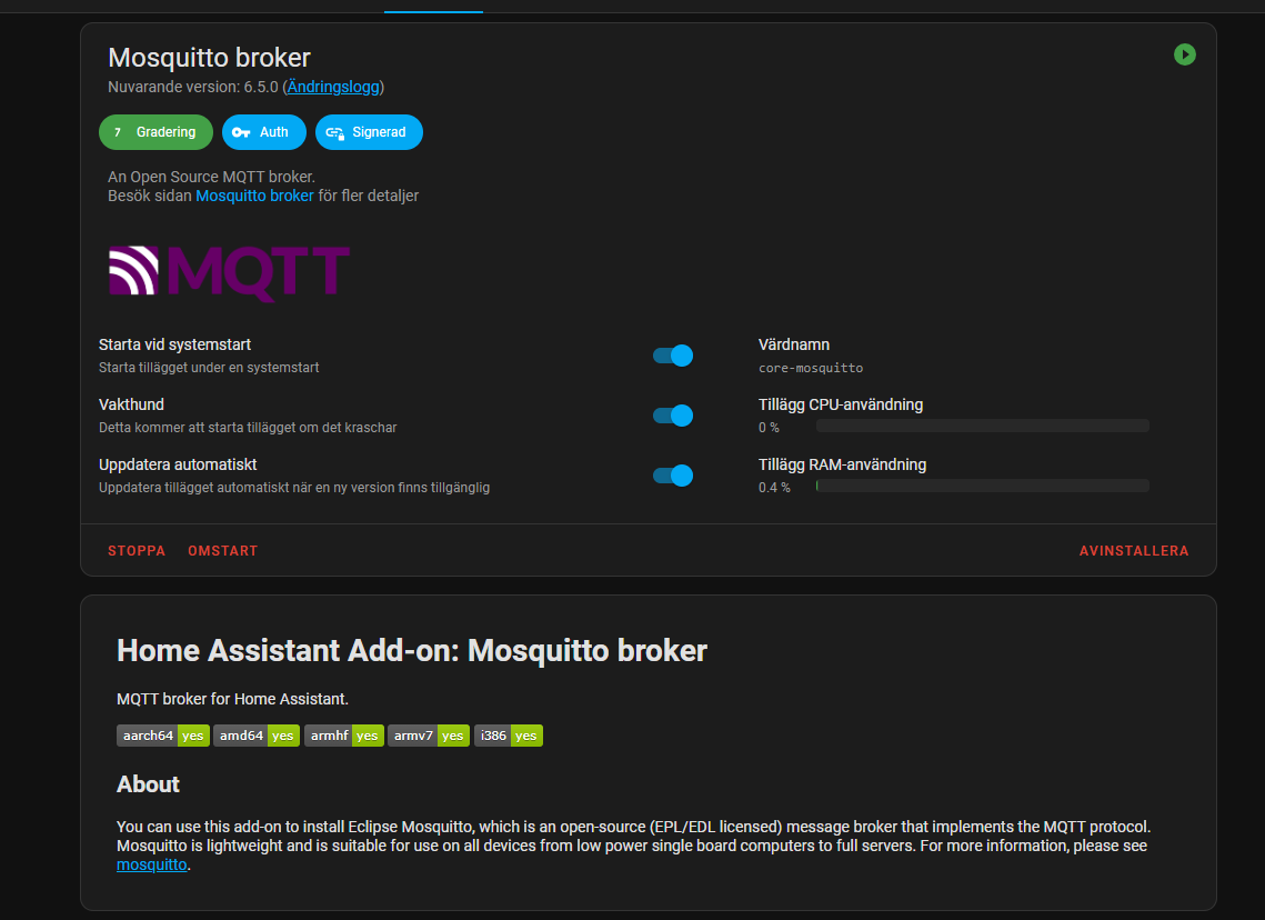

Is broker started?
Only config I have in the broker is that I have added the fullchain.pem and privkey.pem
No config in the mqtt addon as I can see
The thing I had to configure is a user in Home Assistant and set the username and password in the app of the Android TV. After I had done that, it created a successfull connection when I press ‘Test Connection’ in the app.

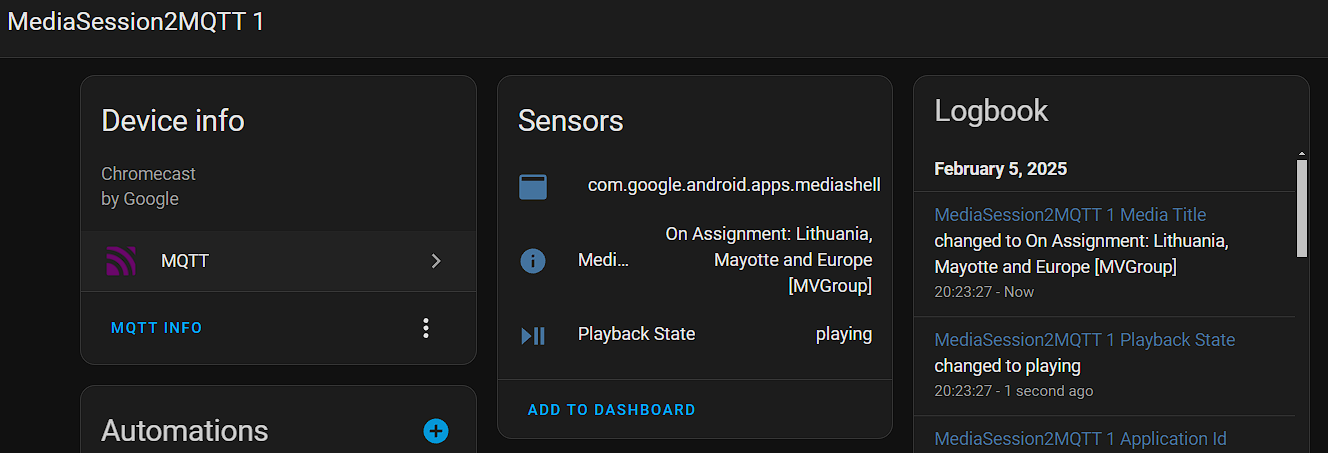

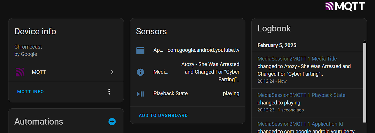

Sorry to randomly jump in but I happened across this thread and just finished building/signing/installing this app. Sign and install were a learning curve :slight_smile:
It looks like this when it works:
Yeah, sorry about what the youtube algorithm picked… I started watching this guy when he happened to cover that youtube streamer in Korea :man_shrugging:
Wow it even gets the title when you cast from VNC. I’m glad I don’t have teenage kids, I’d be setting up an alert on com.google.android.apps.mediashell
