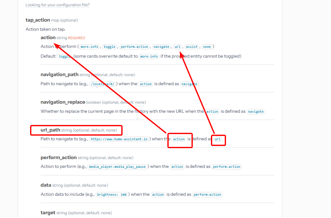

Not explicitly you don’t. Take a look at tap_action: for instance. Yes, you get some text saying a list of strings that it may take - more-info, toggle, perform-action, navigate, url, assist, none as quoted here. But they don’t link anywhere, so that makes them semi-useless, IMO. You have zero idea whether there are more parameters needed (and in most cases there are), and the arguments they take vary for each one. It should be a simple case of clicking on perform-action for instance to find out what extra is needed for perform action to work.
For instance (reason I’ve picked this) is because call-service doesn’t appear to be documented here as a valid action for tap_action but it does work. And it needs both service: scene.turn_on to turn a service on, plus extra data provided in a specific way.

Those are the available values for that option. Continue reading the remaining parameters, they will spell out what action they are attached to.
It’s all covered, you just have to read it.

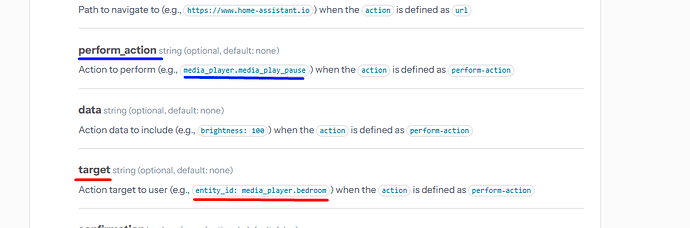

Not sure where you’re getting any of that from the documentation.
The docs mention:
which gets you:
action: perform-action
perform_action: scene.turn_on  #Blue underline
  entity_id: scene.kitchen_lighting_100  #Red underline
Your code shows that you aren’t using the documentation, but examples from the forums which may be outdated.
If you need to use data, it would look like
perform_action: light.turn_on
  entity_id: light.kitchen_light
  brightness: 100
As for how target can be formatted with entity_ids, devices, areas, and labels, it’s the same everywhere and covered here. Yes, the docs could probably use a link to that page.

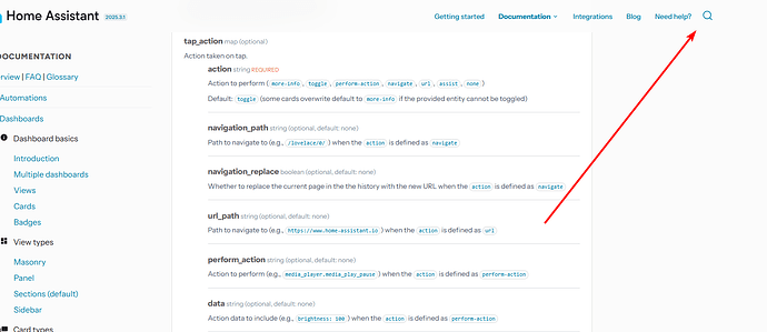

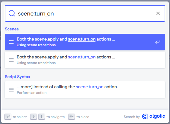

You search for it.
From the release notes.
But you probably started with HA after this change happened.
But that also explains that you aren’t using the documentation for reference.
You should.
The schema for dashboard actions can be found in Dashboards - Actions.

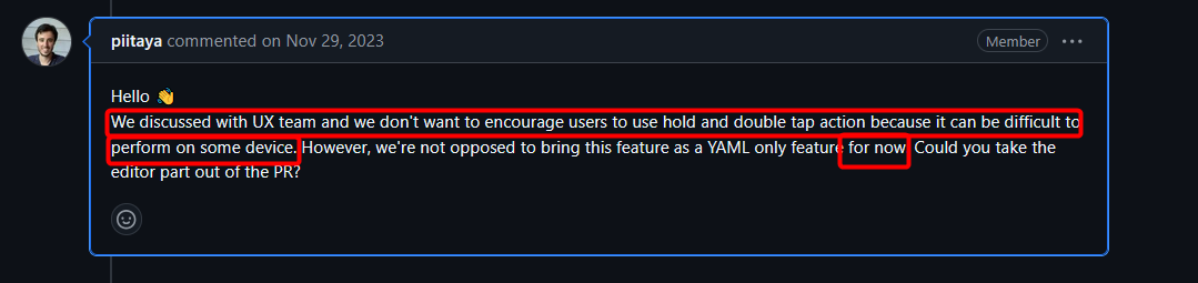

Are you saying the goal is to allow everything to be done in UI? Because I thought this is not true, UI still aims to only provide main or common options while some advanced ones are intentionally kept yaml only. Am I wrong or misreading your point here?
The goal of the frontend dashboard editor has always been to allow the choice between UI or YAML with all options available in both.
Interesting, because there has been some things like this, where a PR included UI configuration, but it was requested to remove it and keep the option to yaml only:
And I’m not writing this to argue, maybe this is just an odd exception, but I thought it was the goal in general
Those are a special case, read the developers response.
Alright. But then it does mean the target for UI does allow for some advanced configuration only being available through yaml.
The developer’s response there is just “done”, not sure what you meant.
Ah, I thought you meant the developer of the PR. I was referring to this specific comment you screenshotted from the start, I thought I linked to it.
