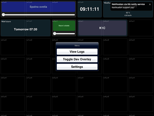

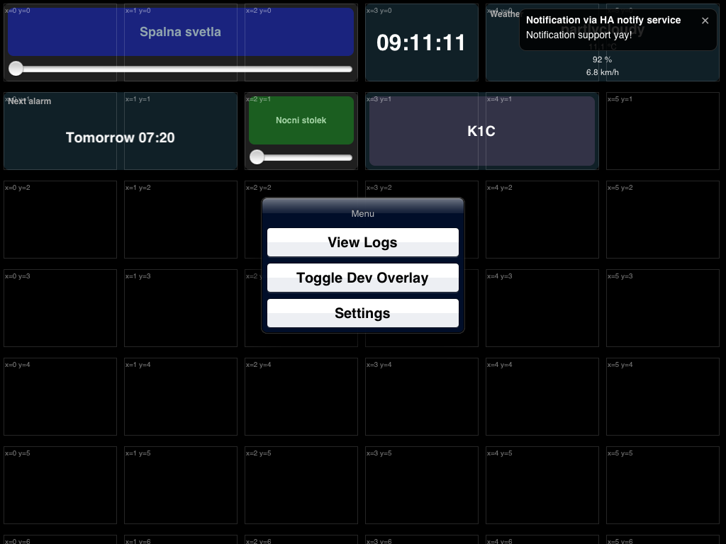

Over the past few weeks, I’ve been developing a lightweight, MQTT-based customizable dashboard designed specifically for the first-generation iPad. It’s inspired by AppDaemon’s Home Assistant Dashboard but optimized for older iOS devices, no websockets or TLS, which helps avoid compatibility issues.

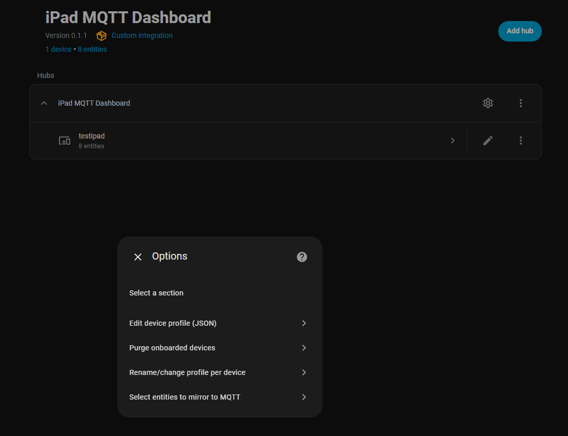

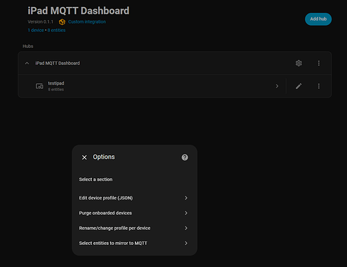

Alongside the iOS app, I’ve built a Home Assistant integration to manage onboarded devices and expose key entities such as battery level, charging status, screen brightness, and keep-awake controls.
I’m currently focused on bug fixes and performance tuning, with plans to release in the next two weeks. Looking ahead, I aim to support all final iOS versions across end-of-life iPads.
A little sneak peak:

I would love to test that on an old iPad 2 I still have. Feel free to ping me if I need to help with testing.
I would like to test to if you don’t mind. I had ipad mini 1, 2 and 3.
Thx for interest. GitHub - 3dg1luk43/ha_mqtt_dash. It requires a bit of tinkering, especially to install iOS app, but I’ve been using it for weeks and it works like a charm on iPad 1.
