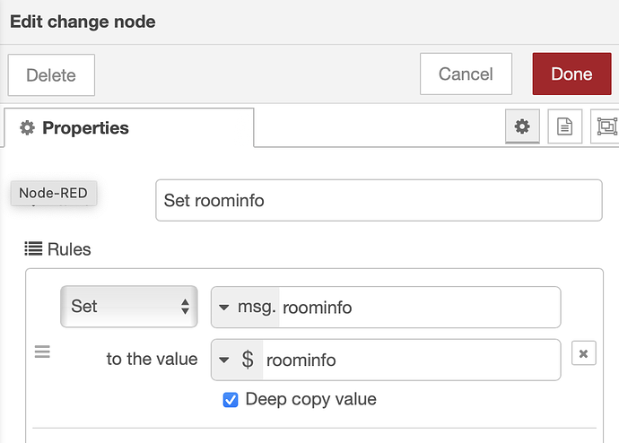

First up to make my flows modular, each room uses a different flow. There are several sub flows that are then shared with these flows.
The flow defines an env var called roominfo which is a json string. This is copied to msg.roominfo before the sub flow is called.

This is copied to msg.roominfo whenever it is needed.
