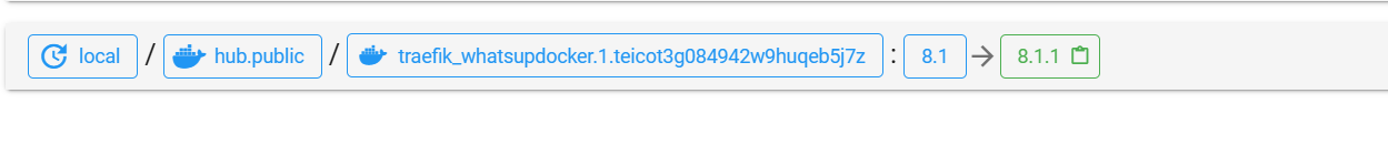

my wud doesnt see all my containers. And also the updates are just wrong e.g. it says 8.1.1 as available update, but I’m already on that version:
I run a swarm service on a single node:
  whatsupdocker:
    image: getwud/wud:8.1.1
    networks:
      - inbound
    volumes:
      - /var/run/docker.sock:/var/run/docker.sock
      - ./wud/store:/store
      - ./docker-compose.yml:/wud/docker-compose.yml
    environment:
      - WUD_WATCHER_LOCAL_SOCKET=/var/run/docker.sock
      - WUD_AUTOUPDATE=false
      - WUD_WATCHER_LOCAL_WATCHBYDEFAULT=true
      # optional but handy when triggering compose updates
      - WUD_TRIGGER_DOCKERCOMPOSE_WUD_FILE=/wud/docker-compose.yml
      - WUD_TRIGGER_DOCKERCOMPOSE_WUD_PRUNE=true
      - WUD_TRIGGER_DOCKERCOMPOSE_WUD_AUTO=true
      - WUD_WATCHER_LOCAL_WATCHDIGEST=true
    labels:
      - "wud.watch=true"
      - 'wud.tag.include=^\d+\.\d+\.\d+$$'
      - 'wud.link.template=https://github.com/getwud/wud/releases/tag/$${major}.$${minor}.$${patch}'
    deploy:
      placement:
        constraints:
          - node.role==manager
Looks like it is probably digest related as 8.1 and 8.1.1 have the same keys on them when i look. Maybe it thinks the installed is the 8.1 version based on that.
