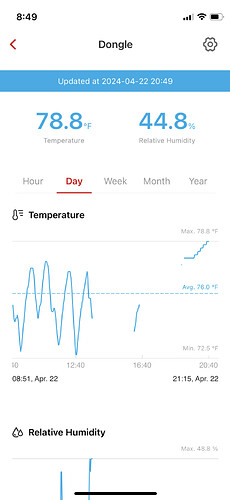

Here is what a temp/humidity dongle provides, by the way. Not sure if it is anything revolutionary
