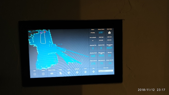

Where did you get the picture from?
it’s my HA with Kejszijo config

Here is a higher contrast background image I cropped together that works well with the color scheme and text.
@jwillaz
thank you
yes is better

@cnrd thks for these new step to integrate the map as background. Did you succeed to refresh the picture ? by me even is the automation is able to refresh the locale picture, the picture display doens’t update (seems to be cached).
No, It hasn’t. Thx

Working like a charm! Next step adding the live maps!

Mine looks like this with appddaemon hadashboard
