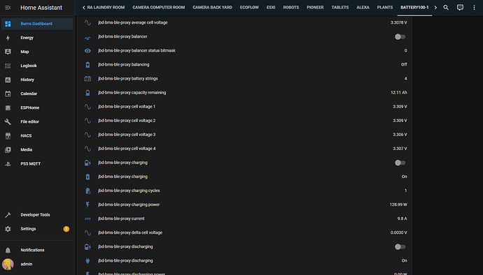

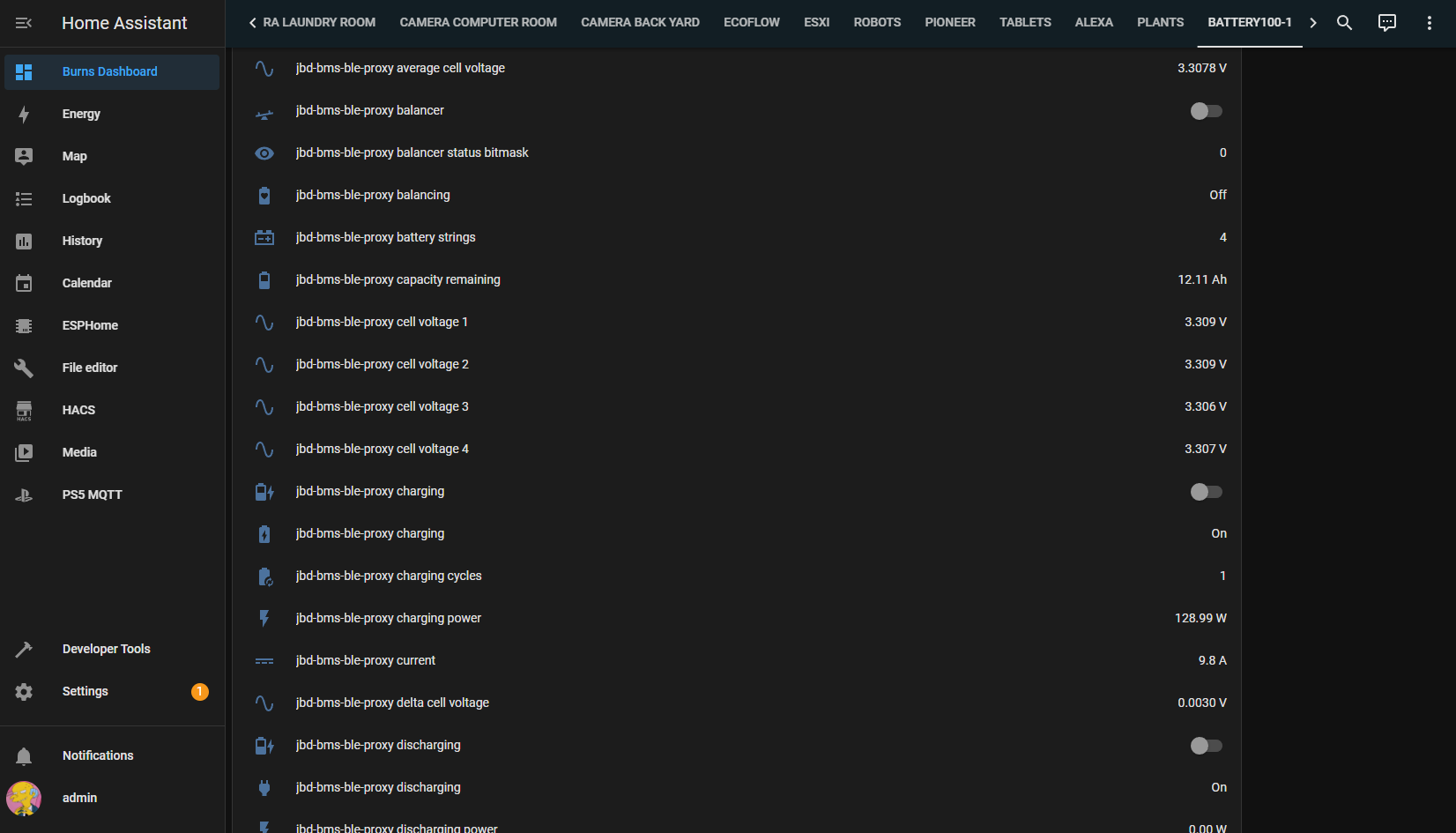

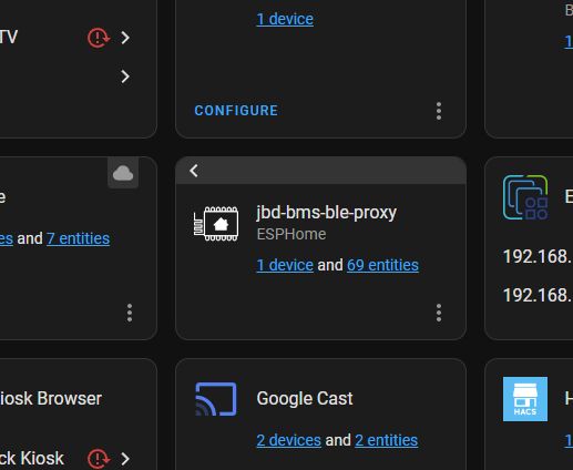

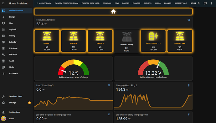

SUCCESS! I was not able to get Batmon to work but penquinponics post led me down the correct rabbit hole! Ended up finding syssi/esphome-jbd-bms I re-compiled one of my proxies and VOILÀ. I have added my esphome yaml below for anybody that needs it. Thank you every one for the suggestions.

  - platform: jbd_bms_ble
    jbd_bms_ble_id: bms0
    errors:
    operation_status:
      name: "${name} operation status"
    device_model:
      name: "${name} device model"
switch:
  - platform: ble_client
    ble_client_id: client0
    name: "${name} enable bluetooth connection"
    charging:
      name: "${name} charging"
    discharging:
      name: "${name} discharging"
    balancer:
      name: "${name} balancer"
ESPHome Proxy
@flap testing energy but need to wait for data to populate(couple hours) thanks for another great update!
that’s awesome!! glad you got it! thanks for sharing!

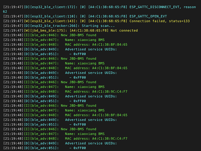

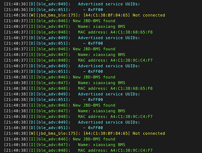

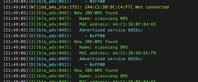

  • address: device1
    type:
    alias: bms1
  • address: device2
    type:
    alias: bms2
  • address: repeat as needed
I’m stumped. I have 3 batteries. Just trying to get one of them working first before adding the others. I have the MAC addresses. When I put one of the MAC addresses in the esphome yaml, no matter which one I put in there, it shows up as “Not Connected” in the Logs. It shows the other 2 batteries as new/discovered. Why would this happen?
Ooh, I didn’t realize auto discovery works. What’s your config look like? Mine is literally six lines for my two BMS.
