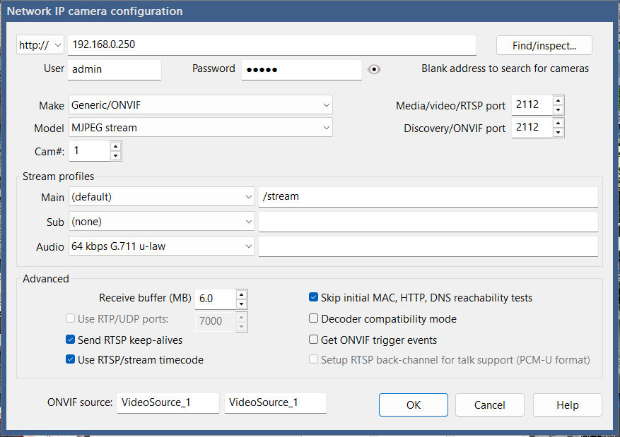

Here’s what my configuration dialog in Blue Iris looks like. Any differences to yours?
However, Blue Iris shows “Cam24: No Signal” and “HTTP: 12029 Cannot connect”.

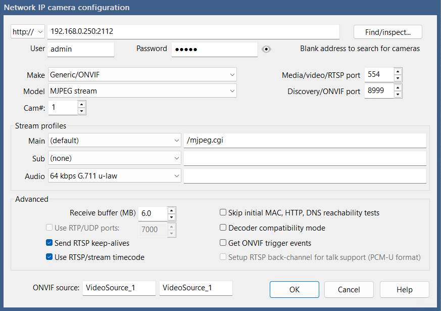

I just tried exactly that, and it worked! Thank you @jeffcrum!
So the trick is to put the port number in the address, not in the port boxes on the right. Also, no need to add the /stream to the profile, it can be left as /mjpeg.cgi. So just set the address and the Model, and voila it works! Here’s a capture of the working configuration:
