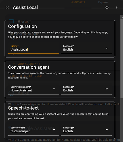

Not sure if I should start a new thread but I have an existing ESP32 that was acting as a Bluetooth Proxy and wanted to add voice detection to it so I added the below code. It doesn’t have any errors (comiles fine and doesn’t give serial log errors while running) but I don’t get any wake word action from it so not sure where to go next…
Code ‘borrowed’ from this forum.
ESPhome code

Voice Assist settings:
ESPhome logs

Any tips of what to test?
Currently the code which is on github uses just a single part of the Esspressif ADF and has the VAD turned to max which is the most restrictive, likely due to false detection.
Also there seems to be little data on initial input volume or AGC and likely an option to trigger and capture the pcm so you can have a quick look in something like Audacity would tell much and having a setting for VAD threshold would likely be a good idea.
I guess a search for Event Type: 2 as must be documented somewhere but likely will have to trawl code.
I know of this software but how do you suggest using it in this instance?
Dunno as its often an ommision but a option to record to file is a god send for debugging and setup to get optimal volumes and testing.
