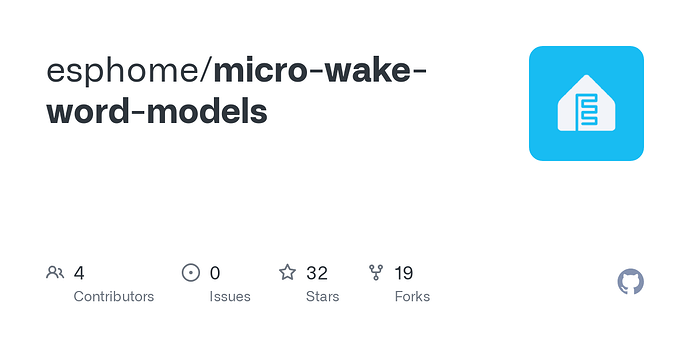

Here is quite the collection English wake words.
Those are only ”OpenWakeWord” models for remote on-server wakeword (with the server always listening) so they do not work on the Home Assistant Voice Preview Edition as that requires ”Micro Wake Word” models for on-device wakeword that can run the locally on the ESP32 microcontroller. While you could techically get the old OpenWakeWord to work running remotley, the new default standard is to use MicroWakeWord instead:

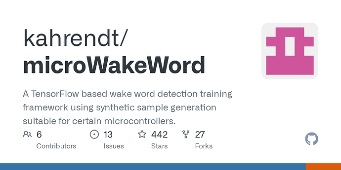

About on-device wake word processing (microWakeWord)
The microWakeWord created by Kevin Ahrendt enables ESPHome to detect wake words on devices like the ESP32-S3-BOX-3.
Because openWakeWord is too large to run on low-power devices like the S3-BOX-3, openWakeWord runs wake word detection on the Home Assistant server.
Doing wake word detection on Home Assistant allows low-power devices like the M5 ATOM Echo Development Kit to simply stream audio and let all of the processing happen elsewhere. The downside is that adding more voice assistants requires more CPU usage in Home Assistant as well as more network traffic.
Enter microWakeWord; a more light-weight model based on Google’s Inception neural network. Because his new model is not as large, it can be run on low-power devices with an ESP32 chip, such as the ESP32-S3 chip inside the S3-BOX-3! (It also works on the, now discontinued, S3-BOX and S3-BOX-Lite).
