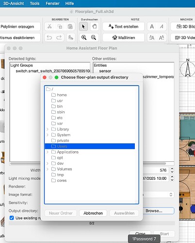

Hi @shmuelzon , great job very helpful plugin. I’m starting to use it and in Mac when I click to browse and select a folder all of them are not selectable also there are no documents or download folder
Hey, I don’t have a Mac to work on it myself but a few others have documented how to work around the MacOS Sandboxing and managed to get it working. You can find the details at: javax.imageio.IlOException: Can't create an ImageOutputStream! · Issue #91 · shmuelzon/home-assistant-floor-plan · GitHub

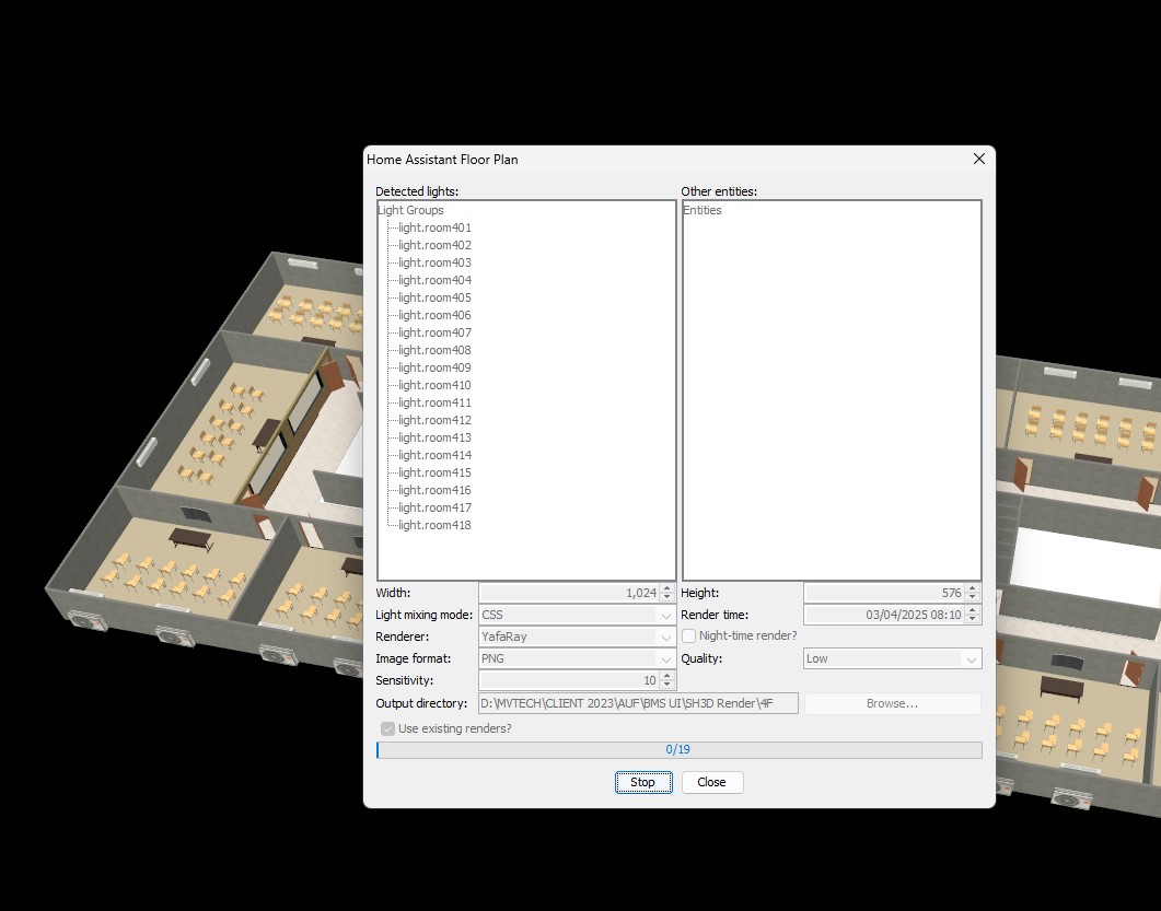

Hello, im stuck after click start noting happen waited for several hours nothing stuck in this page
i try quality high / low same
please help thanks

I can’t change or enter the Output Directory.
What can I do ?

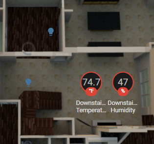

im using picture elements with horizontal stack. i have the renders with multiple light sources working fine, but i have a constant spinning circle. When I click the floorplan outside of a light entity, i get a large opaque circle that covers the whole screen. Does your plugin address this?
Hey, do you see any CPU usage after clicking on the start button? Does rendering an image via SH3D’s menu work?
There are a few limitations when using MacOS that are described at: javax.imageio.IlOException: Can't create an ImageOutputStream! · Issue #91 · shmuelzon/home-assistant-floor-plan · GitHub
Please try to follow the workarounds described there and see if it helps
I never used a horizontal stack so I can’t comment on what it does. Where does the spinning circle come from? What else is overlayed on top of the floor plan? I’m guessing that, whatever it is, it responds to the clicks and adds the white highlight. Nothing the plugin generates will do that on the entire floor plan.

I try this
" Steps for the best I can do:
  1. Create a folder in home directory (just for existence check): /User/bob/floorp
  2. Open extension in SH3D and manually change the output directory to just the folder name: floorp
  3. Start the render.
  4. The files will be output to: /Users/bob/Library/Containers/com.eteks.sweethome3d.SweetHome3D/Data/floorp/
  5. Note that this directory cannot be easily accessed in Finder (Mac’s “File Explorer”). To show it, use the Finder “Go To…” menu and enter the full path above. Alternatively, you can cd in the Terminal (console) app. "
and it works.
Maik
