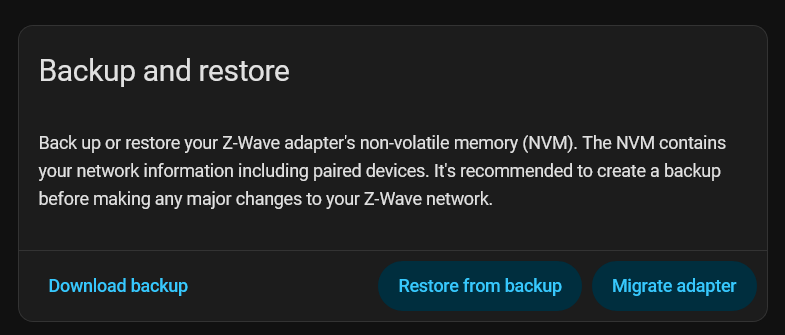

Darn - new problem now that’s pretty annoying, and I can’t say for sure it’s related to this antenna or something but I did a Z-wave backup of my network from the device interface page, which worked. But now every now and then while using the web UI (lovelace) my computer downloads another backup file! It’s kind of random when it happens but something is triggering the system to push a download every now and then.
Anyone seen this problem?
check the zwuijs > web ui > settings and see if backup is enabled and adjust as needed.

That doesn’t seem to be a feature or option for me - I’m using the Z-wave JS add-on. I went to the add-ons section > z-wave js > configuration and there’s nothing about backups there.
Here’s what I did:
I clicked on Download backup and got a backup file. But then I navigated away and started working on automations, entities, etc. and randomly I get the same download triggered.
It’s still happening today but I was going to upgrade to HA 9.x so I’ll see if that fixes it (just a full restart basically).

So after an upgrade to the latest and a restart the problem went away, so I guess I’ll just wait and see if it happens again. Strange.
I had this happen to me too when I backed up before moving to the ZWA-2. I think I did the something similar (navigated away to do something else)…but honestly can’t say for sure. I think I might have resolved it by closing all of the chrome tabs I had open to my home assistant instance and starting fresh. I’m not 100% certain, but it hasn’t come back (haven’t tried another backup since on the other hand). Just wanted you to know you weren’t the only one. If it happens to me again, I’ll try to pay more attention to details and document the issue better - it was a busy time for me when it happened originally and I couldn’t devote much attention to it.

I did get 2-3 sudden/extra ZWave-JS backups the day I did the conversion to the ZWA-2, but not since. My guess is “something” in an odd state resolved with a reboot, and I rebooted may times that day. FWIW…
