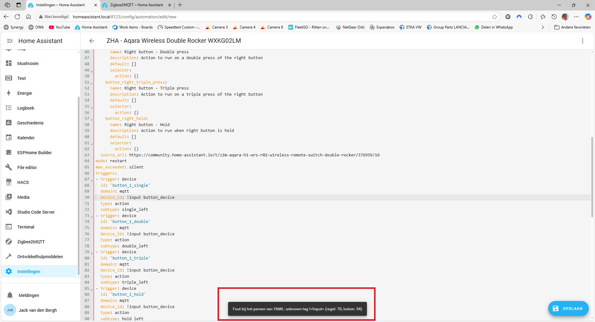

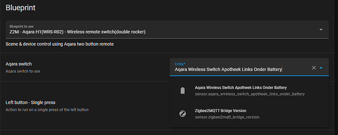

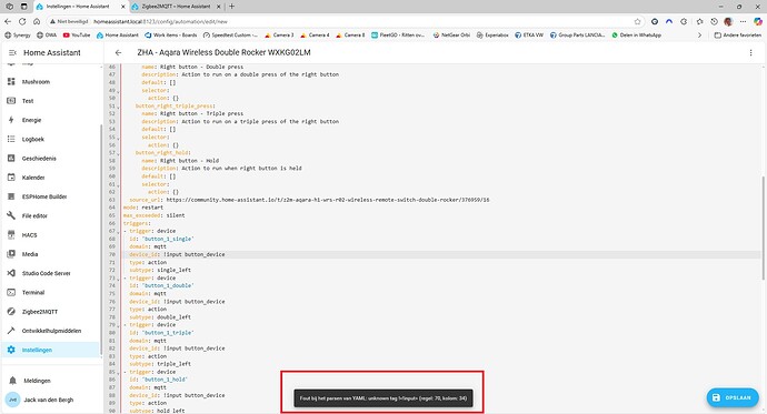

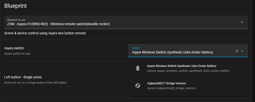

Yesterday I connected my Aqara H1 switch WXKG15LM to HA and saw this blueprint to get the multi buttons working. I have imported the blueprint and linked the automation to it, but unfortunately nothing happens when I press the button on the switch. I may have missed something that is causing it not to work.
I hope someone can help me so that I can get the buttons working. I was able to change the status from single button to multi by quickly pressing the left button 5 times.
2024-06-20 07_53_30-Window
Thank you.

i only see a battery power sensor… how come? i deleted the switch and added it again. changed to fast and multi.
same here, only able to select a bunch of battery sensors, but no remotes much less the H1. =\
i only just figured this one out, did you manage?
Can I ask how you figured this out? I only see battery sensor too.
use Marcus’ blueprint, select the sensor and save it. go back out into the automation page and you will see an error for that automation, go back in and now the device should appear.
Still no joy. The only entity I get is sensor.main_light_battery, I don’t get an error on the automation, nor does anything new appear when going back in.
I have it in multi mode but I don’t know about operation mode - could that make a difference? I can’t seem to change it from event to command anyway.

Hi, can some help me why I’m getting this error when edit the YAML of the/this blueprint(s)?
Unknown tag !
