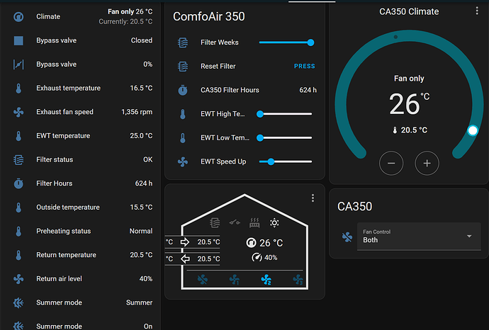

The graphs you now show are normal, its still in “summer mode” but this sun symbol alone doesn’t say much. Not even sure why it has such an indicator. The more important indicator is the bypass symbol (second one counted from the left). If the bypass is active you get cold air into the house to cool the house down after a day when the sun is burning on the house. Although this valve system probably doesn’t get activated because your target is 24C now.
If this unit is already three years there and hasn’t been refurbished / maintained / touched in the last months then I shouldn’t worry too much. However, a quick check if everything is healthy cannot hurt of course. Clean air is important.
With the exception that you can’t get supply (from Comfair to the room) temperature higher than the return (room) temperature. Unless there is some kind of additional heating going on on the pipes e.g. from house heating, kitchen etc. This would suggest to me that the sensor is not calibrated or faulty (assuming that all the connections are correct).
Never seen the bypass symbol on (closed) to be honest also in the past months of the year (I’ve been using this ESP monitoring since Jan 2024).
I’m pretty sure there is no additional heathing or the like in the system.

Well… Outside temp. 15.5 I noticed on your screenshot. I finally have HA running, with the “default” wichers comfoair-card.js. This is a bigger temperature difference and I guess it needs to have a bigger temp. difference to get out of summermode. Although summer/wintermode seem to have no effect at all on anything.
