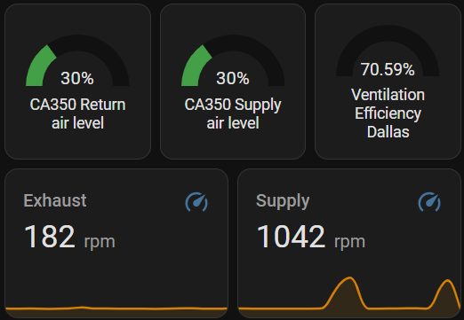

Anyone else experienced drops at the exhaust fan rpm?
Correct Speed Low Fan:
18-10-2025 18:30:06 DEBUG: published message 30 on topic comfoair/intakefanspeed at Sat Oct 18 18:30:06 2025
18-10-2025 18:30:07 DEBUG: published message 25 on topic comfoair/exhaustfanspeed at Sat Oct 18 18:30:07 2025
18-10-2025 18:30:07 DEBUG: published message 904 on topic comfoair/intakefanrpm at Sat Oct 18 18:30:07 2025
18-10-2025 18:30:07 DEBUG: published message 741 on topic comfoair/exhaustfanrpm at Sat Oct 18 18:30:07 2025
RPM Exhaust lower / Intake higher than usual:
18-10-2025 18:20:16 DEBUG: published message 30 on topic comfoair/intakefanspeed at Sat Oct 18 18:20:16 2025
18-10-2025 18:20:16 DEBUG: published message 25 on topic comfoair/exhaustfanspeed at Sat Oct 18 18:20:16 2025
18-10-2025 18:20:16 DEBUG: published message 1042 on topic comfoair/intakefanrpm at Sat Oct 18 18:20:16 2025
18-10-2025 18:20:16 DEBUG: published message 29 on topic comfoair/exhaustfanrpm at Sat Oct 18 18:20:16 2025
Seems like a serial communication error?

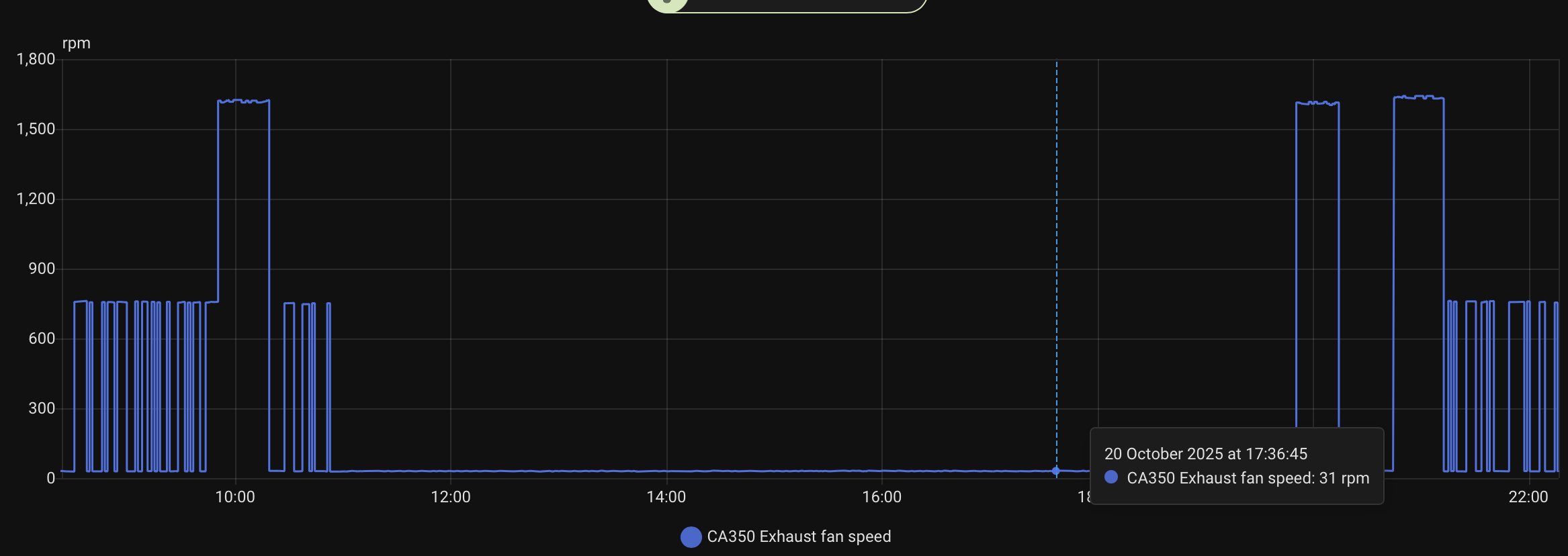

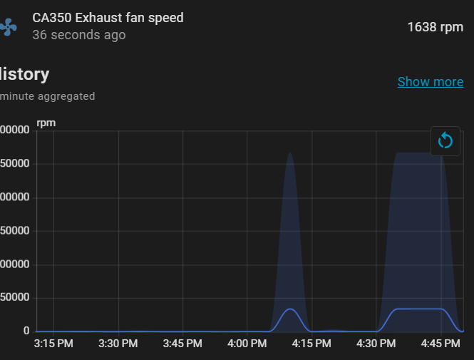

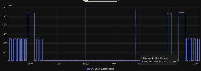

I have the same issue since a while. It was working ok when I set it up but since a year or so on one speed it always shows much lower RPM value. On different speeds the reading is ok. I would bet that something is wrong in the unit itself, e.g. failed sensor or something.
The same sensor also shows some extreme values:
The intake fan RPM sensor looks all good at the same time.

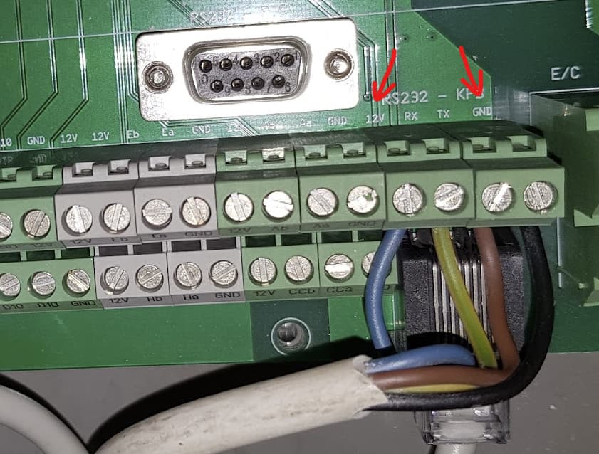

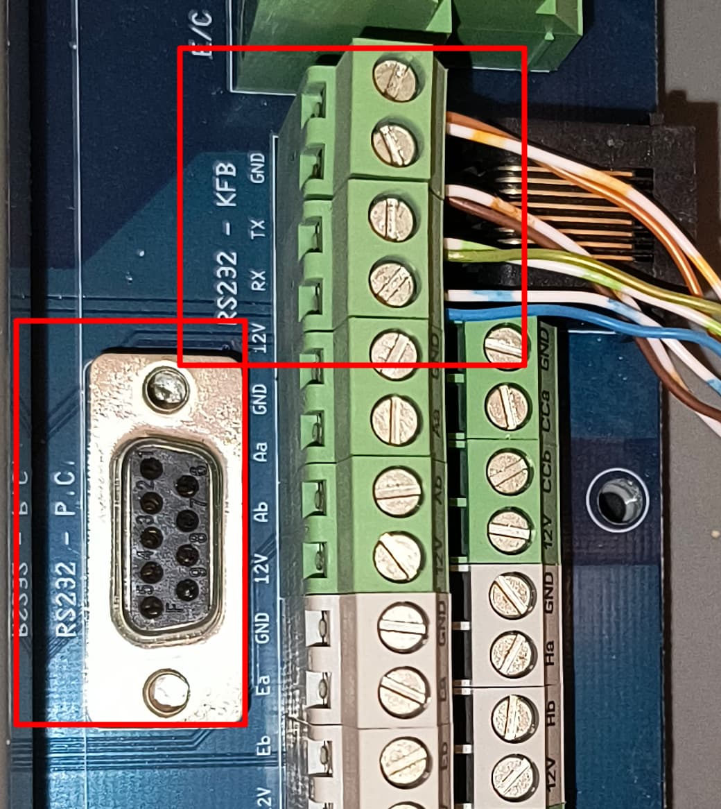

I’m using this module and I’m powering it from here:
I have it running since Feb and no problems whatsoever. The python script deployed in docker as per the wiki guide.

There is no plug and play solution to integrate Comfoair with HA. This discussion is about controling it via RS232 and to find which solution is the best for you I’d start with checking the possible deployment options in the wiki:
Personally I find the easiest to buy an RS232-WiFi (or ethernet) bridge. This one: RS232/485 TO WIFI ETH (B) ttps://www.waveshare.com/wiki/RS232/485_TO_WIFI_ETH_(B) can be powered from comfoair directly so number of connections and cables is minimized. I’m using it with the Docker deployment method, also described in the wiki.

What ready‑made cable can I use to connect the Aeris RJ45 RS232 port to the Waveshare DB9 RS232 port?
I know I could build a custom cable if I had the pinout, but I’d prefer to buy a reliable off‑the‑shelf solution (like a Cisco console cable or similar) if possible. Has anyone here already done this and can recommend a specific cable or adapter that works?
Thanks for any advice or product links!
Marcin
I don’t think you’ll find such cable. Just get an RS232 cable, cut it to the length you need and connect to the KFB screw terminal on comfoair control board as per the cable description from this post, the other end to the RS232 port of the waveshare module. That would be the easiest way without any soldering etc.
Do I understand the steps correctly?
  1. Cut one end of the RS232 cable.
  2. Identify the wires corresponding to the DB9 pins:
    • Pin 2 = RX (receiving on Waveshare)
    • Pin 3 = TX (transmitting from Waveshare)
    • Pin 5 = GND (ground)
  3. Connect the wires to the KFB terminals on Aeris 350:
    • KFB1 → GND
    • KFB2 → TX from Aeris
    • KFB3 → RX to Aeris
  4. Plug the other end (DB9 male connector) directly into the Waveshare RS232 port.
