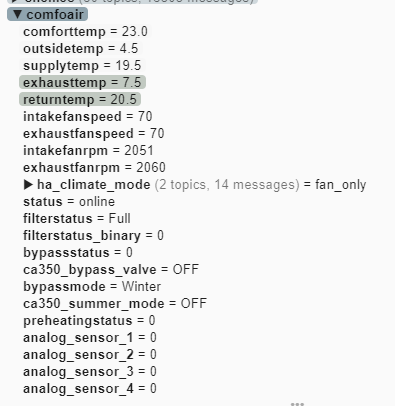

Hi Folks,
can you help me to understand that:
filter status shows ok
this is what i see in MQTT
but in developer mode i see this
My comfoair shows on the panel the filter message, so I have to change the filters
what i should check to understandd if i have or not to change the filters?
any clue?
This is how the binary sensor of device class “problem” shows OK when the status is “off” and Problem detected (not sure what exactly is displayed) when the status is “on”. See documentation here:
@adorobis, I’m confused, in my case the Display shows “FILTER” that means I have to change it,
why I see Problem OK / status OFF? I shouldn’t see Problem XYZ / status ON?
what is I see is filterstatus OK and filter_binary 1, can I take this as the correct threshold?, then it means my expectation is to see the opposite when filter are good
Let me try to clarify
Problem OK / status OFF / filter_binary 1 == Filter Alert, you need to change the filters
Problem XYZ / status ON / filter_binary 0 == Filter are goos, NO need to change the filters
that is the correct status / meaning?
This should be the trigger to raise the alert, right?
The trigger should be from off to on. The other question is why the integration shows OK (off status) while you can see the message to change the filter in the Display. I think this one was difficult to test as I’ve set a date for the filter far in the future so it does not bother me anymore. The best would be if you could debug the python app and see what the RS232 is actually returning, I might have a mistake somewhere there.

I made the change, no changes
I still get OK and 1
Sorry, my mistake, check with data[8]:
def get_filter_status():
    data = send_command(b'\x00\xD9', None)
    if data is None:
        warning_msg('get_filter_status function could not get serial data')
    else:
        if len(data) > 16:
            if data[8] == 0:
                FilterStatus = 'Ok'
                FilterStatusBinary = 1
            elif data[8] == 1:
                FilterStatus = 'Full'
                FilterStatusBinary = 0
            else:
                FilterStatus = 'Unknown'
            publish_message(msg=str(FilterStatus), mqtt_path='comfoair/filterstatus')
            publish_message(msg=int(FilterStatusBinary), mqtt_path='comfoair/filterstatus_binary')
            debug_msg('FilterStatus: {0}'.format(FilterStatus))
        else:
            warning_msg('get_filter_status data array too short')
Almost :smiley:
now the MQTT message is correct
but the entity remains stuck on OK
It can be we need to change the topic?
problem: on means problem detected, off means no problem (OK)
            if data[8] == 0:
                FilterStatus = 'Off'
            elif data[8] == 1:
                FilterStatus = 'On'
I delete the MQTT device and restarted the script, but the sensor still shows OK
Rather this way, as FilterStatus is a text sensor and FilterStatusBinary is the one you are looking for to fix:
            if data[8] == 0:
                FilterStatus = 'Ok'
                FilterStatusBinary = 'OFF'
            elif data[8] == 1:
                FilterStatusBinary = 'ON'
