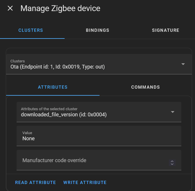

Hi, Iāve been trying to update my remote from 0x00010012 to 0x01000035, but getting nowhere. Iāve updated some other Ikea remotes (with some difficulty) before, but this one seems to be completely refusing. The buttons besides the dots work, but none of the steps in the linked ZHA OTA guide work. The service call goes through (only if Iām pressing buttons on the remote while calling), but alas, no update seems to start.
Also, checking the current version via the cluster gives me āNoneā:
Any ideas?
