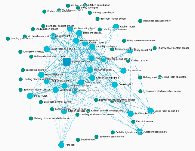

ZHA Needs Reloading Often
More routers would help. In your image you have very few connections between routers - the main links seem to be back to the coordinator. If one of your devices is sending an abnormally high number of messages the mesh will get clogged up very quickly. You need a lot of connections so that there are alternative routes.
