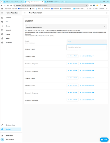

Hello, it is me again. The newbie trying to make use of a set of 4 Vesternet 4 button zigbee switches I got for a good price. Maybe there was a reason for that…
I have managed to factory reset one device for testing and I have also joined it to HA using ZHA.
I have found this thread discussing the Robb 4 button switch which apparently is the same device. Hence I have imported the 4 button version of the blueprint above.
So far so good, this is according to the description found here.
When I try to create an automation using the Robb blueprint, I am unable to select an input device.
This throws me off for a while until I realise that the code that was graciously shared in this thread locks the blueprint to devices with the manufacturer entity set to “ROBB smarrt”. Thinking I am a clever sod and an ex-developer I expect to be able to create a new instance of the blueprint into which I can modify the manufacturer entity.
That is basically what is described under “Editing an imported blueprint” here.
Unfortunately, when I try and take control, it doesn;t happen as described. I am unable to get an editable copy of the YAML of the blueprint. I can’t get access to the YAML at all.
Any top tips? What is it I am misunderstanding or forgetting?
Yes, I have tried copy and paste of the YAML. I just don’t seem to be able to create my own instance of the blueprint, hence no editable YAML.
