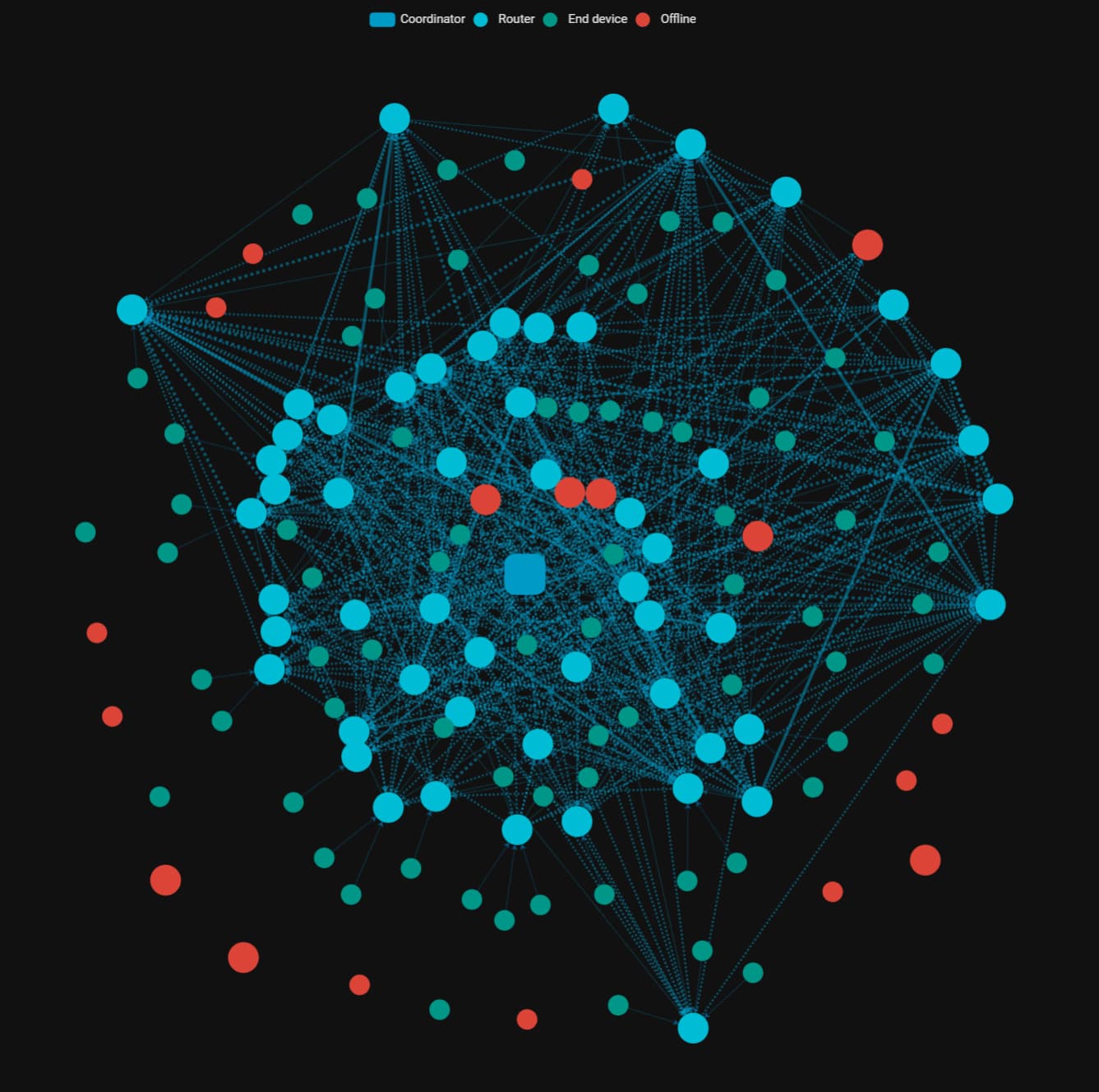

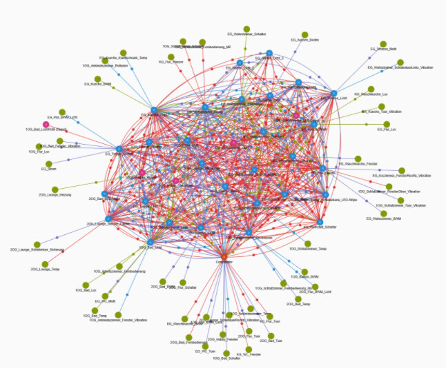

I’m not sure what you guys were referencing, but I saw this picturue in that thread you linked. Looks really clean. You can easily see routers vs nodes:
Much better than ZHA in Home Assistant:
While it colors everything nicely, nodes are placed in random spots. Sure, you can zoom in and see connections, but it’s still not very clear :frowning:. I wish it could make more sense. I also liked how the old one showed you the links speeds with colored lines. It worked great when I had a few devices. These days, it’s insane. I’d prefer to only see lines for the preferred (highest speed) link to make it easier to figure out how stuff is roughly connected. Having hundreds of devices makes this basically unusable.
