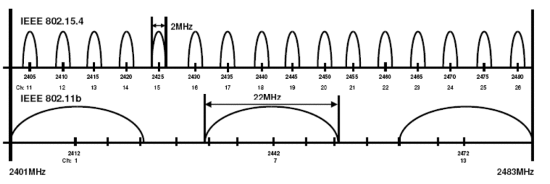

According to a graph here
you should be fine from channel 15 to 20.
I would also search for other reasons.
