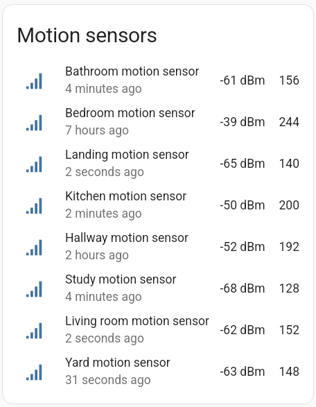

LQI and RSSI values can be useful to give you an overview of how a network is performing, but they change all the time (set up an entities card and have a look).
