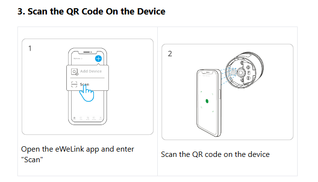

FYI, a few Zigbee devices from Sonoff have a QR code on the device for pairing (available in eWeLink app for Sonoff gateways), at least these:
SONOFF Zigbee SenseGuard Indoor Siren (SNZB-09P)
SONOFF TRV Gen2 Zigbee Thermostatic Radiator Valve (TRV-ZBT)
Perhaps the Open Homn Foundation could as if Sonoff/Itead would be willing to sponsor the development needed for adding this to Home Assistant’s frontend?
