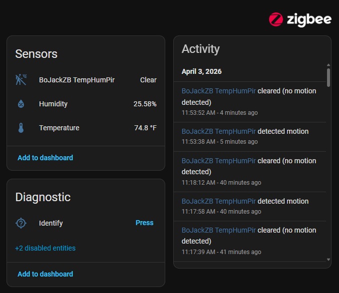

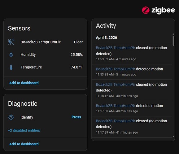

You might want to try arduino again. I was able to easily get a working temp/hum/pir sensor working. I found example code at M5stack for their h2 board and at P-R-O-C-H-Y’s github. Only issue I had was getting reporting working as desired but after reordering the endpoints it now works great w/ ZHA!
