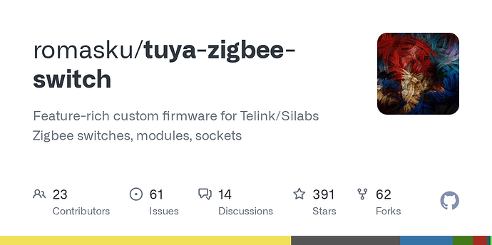

Here is a repo that has custom firmware to support binding for a bunch of Tuya switches. Not sure if it has been posted. Has anyone tried it?
  • Detached mode, e.g. switch doesn’t trigger relay but only generates events via Zigbee
  • Long press for momentary switches with configurable duration
  • Router/EndDevice modes for no-neutral devices
