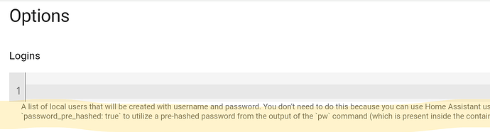

Below are my configurations:
- Mosquitto
logins:
- username: mqtt_user
password: mqtt_pass
require_certificate: false
certfile: fullchain.pem
keyfile: privkey.pem
customize:
active: false
folder: mosquitto
