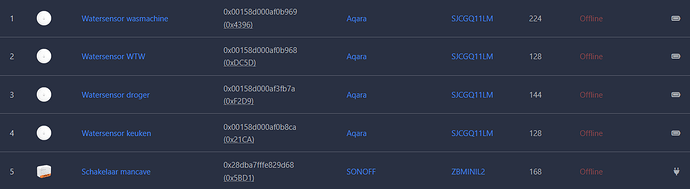

After i did the changes in the configuration.yaml file and i put the “zstack” back to ember, the addon is starting again and the UI is online. But the sensors are stated “offline”
In addition to above: they seem to display the correct status when i put the sensor in the water. I cant just test everyone as them tucked away.
Still it shows Offline in the UI.
