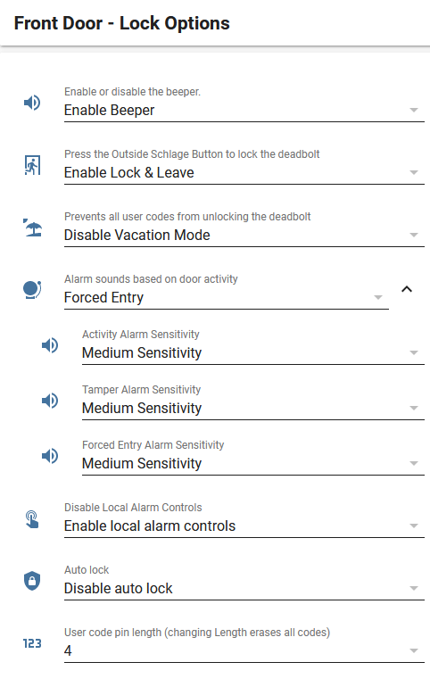

I have partially converted @FutureTense into a multi-lock friendly format by some global replaces, and changed the lovelace around a little bit to save some screen real estate using fold-entity-row. One drawback is that amount of objects/js being run starts to lag the browser a little bit, especially on mobile.cod2
I think it is still broken, all the entities dissapear after I load in multiple folders,but you can see my progress here.
I too was fiddling around with folding row, but didn’t want to require it for anyone just yet. I’ll probably get back to that soon. I’ve been cleaning a few things up. Mainly how one goes from adding a new zwave device to renaming it to work with the default package. I just made a push a while ago. JavaScript is the bane of my existence for these type of “single” pages, yes it gets large fast. It would be nice if the Devs could give us the option to add multiple Lovelace pages. Since the lock settings are rarely used, I would bundle the entire thing away on its own page if I had my druthers.
I like the lock options you added. Maybe we could collaborate on the same github instead of just copying code back and forth. I think we’ve covered all the options one could want for lock access.
