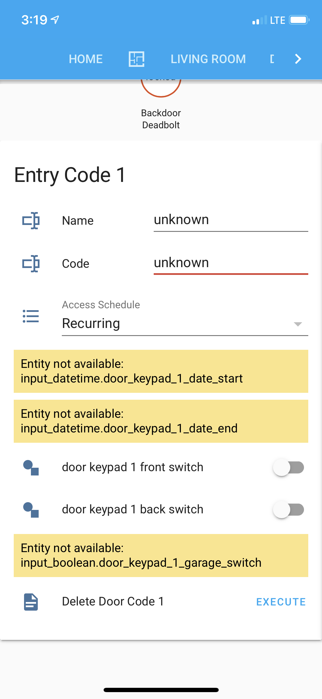

I hope someone might be able to help me out. I think I am so close to a successful installation of the lock manager. For some reason input_datetime.door_keypad_1_date_start type entities are not loading. The main feature of the manager I wanted was the scheduling of certain codes.
This is what the lovelace swiper cards look like. Any insight is helpful![/wrap]

Hi I just bought a Kwikset 910 Z-Wave Plus lock and was just curious if someone could write up a step by step to get this setup? I keep modifying the files in packages and keep getting Entity ID missing on lovelace.
Thank you!
So 95% of the time when lovelace says “Entity ID missing” it’s because the entity is missing. :slight_smile:
seriously, though, that is what it means. What entity does it say is missing? Look at all of your entities in HA. Do you see it? Often it’s a typo, or name changed during your modifying the packages. Do you just have one lock?

OK, next. which entities are “missing” according to lovelace?
The lovelace config on your Github gives me the error ‘No card type found’.
On the one you posted on here a while back, I get the following
I understand back switch and garage switch entities are not available, but I’m unable to modify ‘Name’ ‘Code’ or access schedule on any of the user code swipe cards.
Got it, so a while ago, I switched to using google calendar for my scheduled codes. And the old lovelace is for before google calendar. Do you use google calendar? If so, I’ll work with that, if not I’ll get you the version before google calendar and we’ll get it working either way.
Here was the post. I know these things get buried in the long posts
you probably needed to add the atomic calendar lovelace plugin
