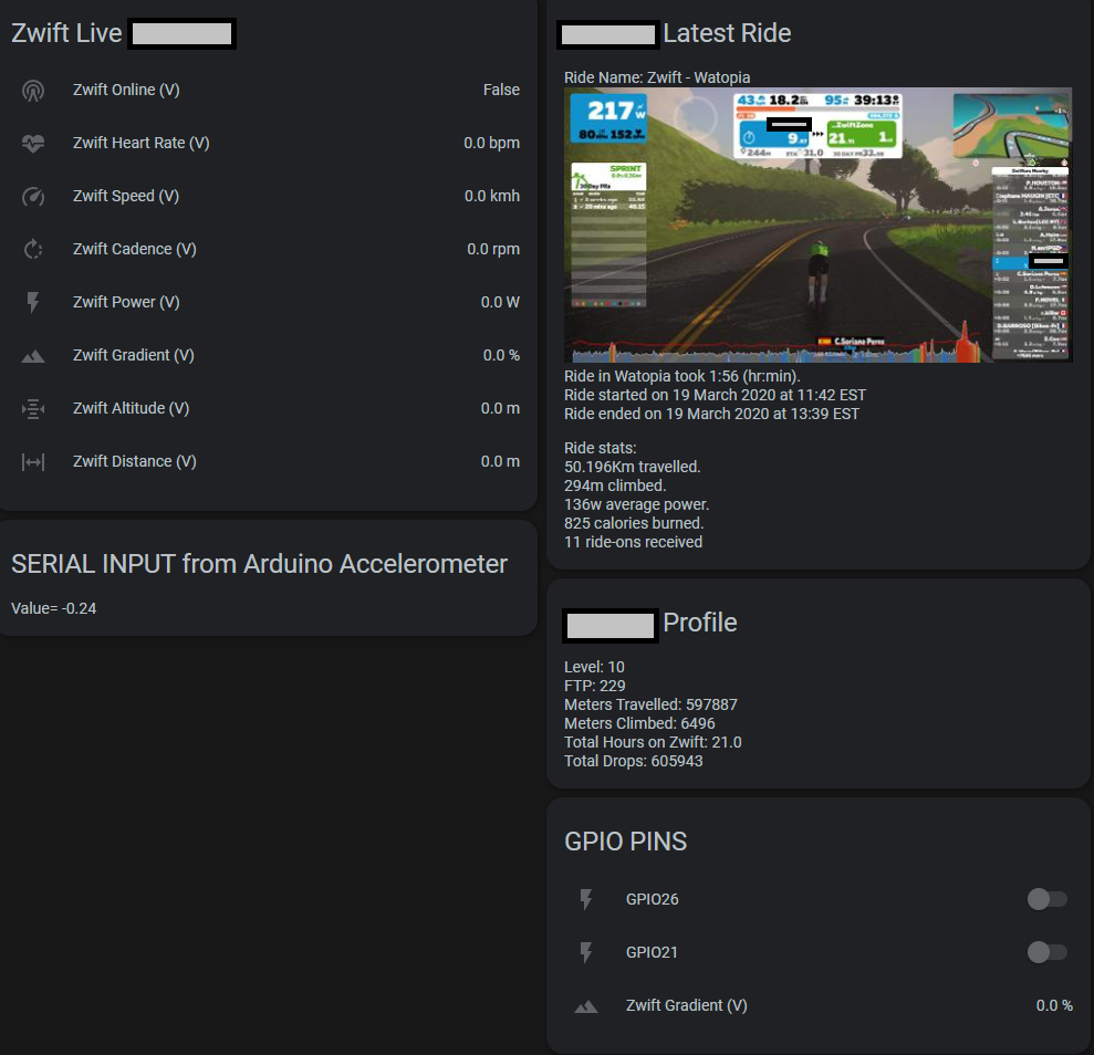

Excellent! I’m in business. Made a lot of progress today. my end goal is a diy Kickr Climb. after my progress today I was confident enough to place an order for the remaining hardware.
I’ve made small modifications to the code that @Maurice_van_den_Hoog provided and have a great dashboard. I’ve also integrated some rudimentary GPIO switches on my dashboard which I’ve verified are working. I have also created a serial input, for the Gradient/angle sensor (MPU6050) which is being fed from an Arduino Uno. I couldn’t get the MPU working on the Pi but it was quite easy with the arduino
this should allow me to grab the gradient from the current activity, and tell my linear actuator (driven through L298N driver) to keep moving until the accelerometer (serial input) matches what’s coming from zwift.
feel like I’m getting close! thanks for all the help! I’ll be sure to keep updating!
here’s a screenshot
can’t wait to see the finished product!
Wow, nice one @quartapound. Looks great and sounds promising :wink: Also going to create a profile part, as you have done.
