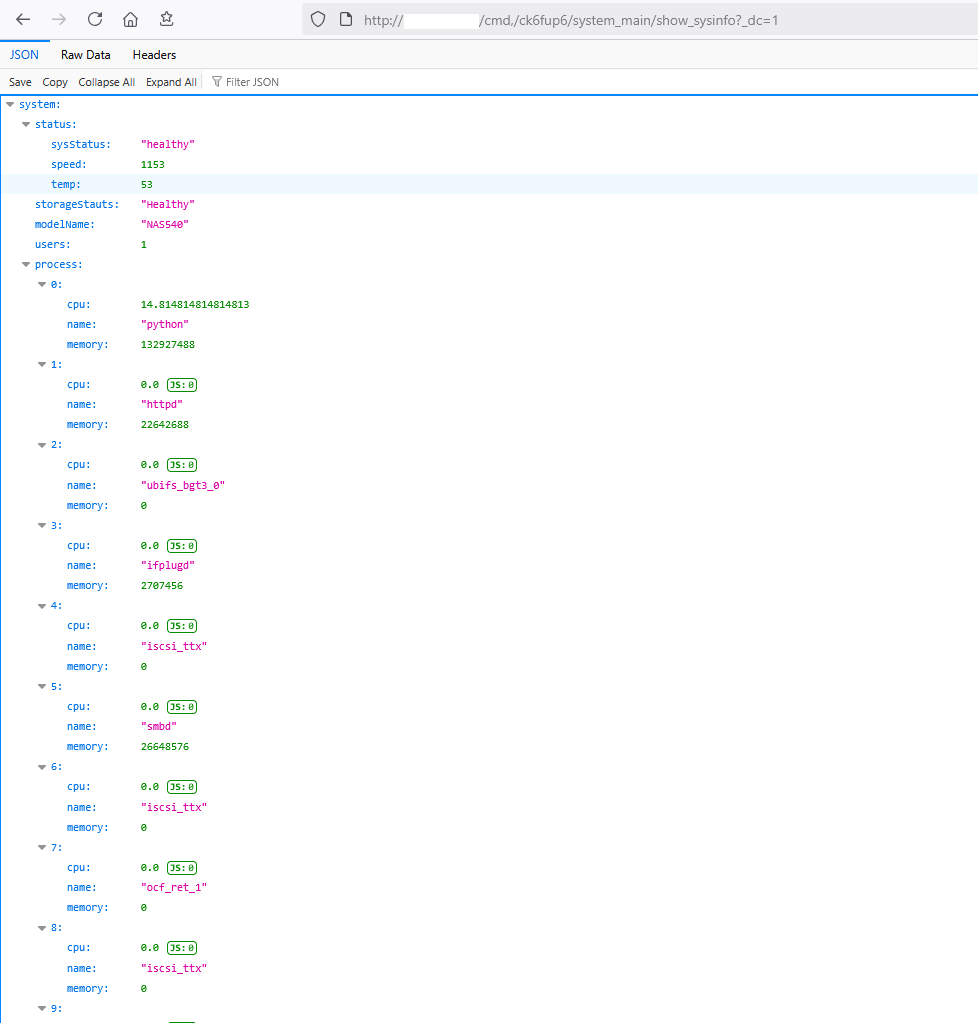

Hi, on my 540 with Firmware V5.21(AATB.11) (r51266) none of the cgi´s (show_sysinfo/zysh-cgi) works for me. Has someone a solution? or can someone describe how to discover the right cgi-string ?
My 540 NAS working no issues.
nas
nas1

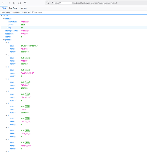

OK Thanks, for your answer, the CGI via Browser ist now working but the sensors gettting no data, what i see is this:
[core-ssh homeassistant]$ cat home-assistant.log | grep 540
2024-03-01 09:39:43.692 ERROR (MainThread) [homeassistant.helpers.template] Template variable error: ‘None’ has no attribute ‘attributes’ when rendering ‘{{ states.sensor.nas540.attributes.cpu_temp }}’
any suggestions `?
How you obtain info from NAS540?
I’m using python script to get all info.
Based on output you provided sensor.nas540 doesn’t have any attributes.
