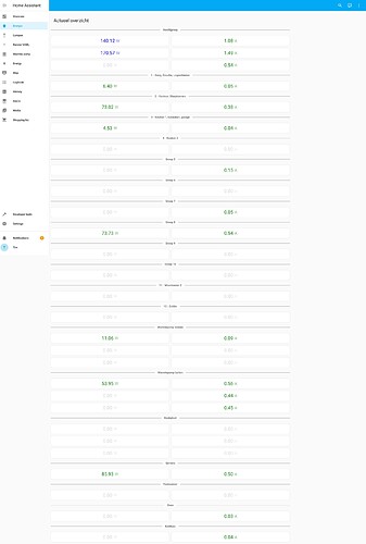

Thanks @iantrich. I’m very happy with this card. Was looking for something to generate ~30 cards. This one saved the day. My card is still a work in progress. But these are the results so far.
views:
  - title: Energie
    path: energie
    type: sidebar
    badges: []
    cards:
      - type: custom:config-template-card
        entities:
          - sensor.100_import_kwh_since_last_reset
        variables:
          DEVICES: [
            {"address_id": 100, "type": "eastron sdm630", "title": "Hoofdgroep"},
            {"address_id": 101, "type": "abb ev1", "title": "1 - Gang, Douche, Logeerkamer"},
            {"address_id": 102, "type": "abb ev1", "title": "2 - Kantoor, Slaapkamers"},
            {"address_id": 103, "type": "abb ev1", "title": "3 - Keuken 1, bijkeuken, garage"},
            {"address_id": 104, "type": "abb ev1", "title": "4 - Keuken 2"},
            {"address_id": 105, "type": "abb ev1", "title": "Groep 5"},
            {"address_id": 106, "type": "abb ev1", "title": "Groep 6"},
            {"address_id": 107, "type": "abb ev1", "title": "Groep 7"},
            {"address_id": 108, "type": "abb ev1", "title": "Groep 8"},
            {"address_id": 109, "type": "abb ev1", "title": "Groep 9"},
            {"address_id": 110, "type": "abb ev1", "title": "Groep 10"},
            {"address_id": 111, "type": "abb ev1", "title": "11 - Woonkamer 2"},
            {"address_id": 112, "type": "abb ev1", "title": "12 - Zolder"},
            {"address_id": 113, "type": "eastron sdm630", "title": "Warmtepomp binnen"},
            {"address_id": 115, "type": "eastron sdm630", "title": "Warmtepomp buiten"},
            {"address_id": 117, "type": "eastron sdm630", "title": "Kookplaat"},
            {"address_id": 201, "type": "abb ev1", "title": "Servers"},
            {"address_id": 245, "type": "abb ev1", "title": "Vaatwasser"},
            {"address_id": 244, "type": "abb ev1", "title": "Oven"},
            {"address_id": 243, "type": "abb ev1", "title": "Koelkast"}
        card:
          type: vertical-stack
          title: Actueel overzicht
          cards: |-
            let cards = [];
            const getDivider = ( title ) => {
                return {
                    'type': 'custom:text-divider-row',
                    'text': title,
                    'align': 'centre',
                    'text-divider-font-size': '20',
                    'text-divider-line-size': '3',
                    'text-divider-margin': '1em 0'
            const getCard = ( state, unit ) => {
                const getColor = () => {
                    let color = '';
                    switch (true) {
                      case (unit === "A"):
                        switch (true) {
                            case (state == 0):
                                color = 'lightgray';
                                break;
                            case (state < q):
                                color = 'green';
                                break;
                            case (state < 6):
                                color = 'blue';
                                break;
                            case (state < 9):
                                color = 'orange';
                                break;
                            case (state => 9):
                                color = 'red';
                                break;
                            default:
                                color = 'purple';
                        break;
                      default:
                        switch (true) {
                            case (state == 0):
                                break;
                            case (state < 100):
                                color = 'green';
                                break;
                            case (state < 500):
                                color = 'blue';
                                break;
                            case (state < 1000):
                                color = 'orange';
                                break;
                            case (state < 2000):
                                color = 'red';
                                break;
                            default:
                                color = 'purple';
                    return color;
                return {
                    'type': 'custom:html-card',
                    'content': `
                                  <div style="display:flex; justify-content:center; color:${ getColor() }" >
                                    <span style="font-size:24px; text-align:ricght;">${ state }</span>
                                    <span style="font-size:20px; opacity:0.5; padding-left:0.5rem;">${ unit }</span>
                                  </div>
            const getRow = (index, id) => {
                let entityCards = [];
                entityCards.push( getCard( this.hass.states[`sensor.${id}_phase_${index}_power`].state, 'W' ) );
                entityCards.push( getCard( this.hass.states[`sensor.${id}_phase_${index}_current`].state, 'A' ) );
                return {
                   'type': 'horizontal-stack',
                   'cards': entityCards
            DEVICES.forEach( device => {
                cards.push( getDivider( device.title ) );
                if ( device.type === "abb ev1" ) {
                  cards.push( getRow(1, device.address_id) );
                if ( device.type === "eastron sdm630" ) {
                    let subCards = [];
                    for ( let i = 1; i < 3 + 1; i++ ) {
                        subCards.push(getRow(i, device.address_id ));
                    cards.push( {
                        'type': 'vertical-stack',
                        'cards': subCards
            cards
If anyone has any suggestions. I’m more than open to it, since it’s my first try.
