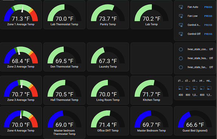

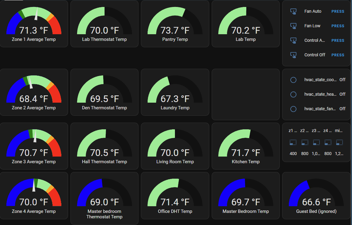

Thank you. In my case the underlying entities are not changing very often, and at least at the moment it’s working nicely. If anyone is curious. I used it on the left (which is the actionable calculated value). The small slivers are the hysteresis range. Deciding if I want to put it on each sensor, but at least in this brief trial it is working great.

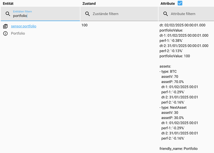

I would like to show multiple attributes of an array in a config-template-card.
Would be nice, if it looks like this:
BTC 70 (70%)
NextAsset 30 (30%)
My input sensor looks like this:
With the following basic code, I got at least a value of the array :smiley:

I would like to show a list of assets in the card with 3 or 4 columns e.g.
Asset | Volume | Percentage | Change since
The number of assets (rows) can change over time.
Above or below the table there should be the total value of all assets.

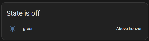

General schema:
  1. variables = list, var_2 does not use var_1.
  2. variables = list, var_2 depends on var_1.
  3. variables = dict, var_2 does not use var_1.
  4. variables = dict, var_2 depends on var_1.
code
  - type: markdown
    content: |
      vars=list
  - type: custom:config-template-card
    variables:
      - states['input_boolean.test_boolean']
        (states['input_boolean.test_boolean'].state === 'on') ? 'red' : 'green'
    entities:
      - ${vars[0].entity_id}
    card:
      type: entities
      title: ${"State is " + vars[0].state}
      entities:
        - entity: sun.sun
  - type: markdown
    content: |
      vars=list
      var_2 ~ var_1
    variables:
        (vars[0].state === 'on') ? 'red' : 'green'
    entities:
    card:
      type: entities
      entities:
        - entity: sun.sun
  - type: markdown
    content: |
      named vars
    variables:
      BOOL: states['input_boolean.test_boolean']
      COLOR: >-
    entities:
      - ${BOOL.entity_id}
    card:
      type: entities
      title: ${'State is ' + vars['BOOL'].state }
      entities:
        - entity: sun.sun
  - type: markdown
    content: |
      named vars
      var_2 ~ var_1
    variables:
      COLOR: >-
        (vars['BOOL'].state === 'on') ? 'red' : 'green'
    entities:
      - ${BOOL.entity_id}
    card:
      type: entities
      title: ${'State is ' + BOOL.state }
      entities:
        - entity: sun.sun

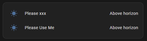

Your fixed example:
    variables:
       child: |
          const c = "Use Me";
          c;
       parent: >
          (passed_var) => {
             const p = "Please " +
               (passed_var ? passed_var : child);
             return p;
    entities:
      - sun.sun
    card:
      type: entities
      entities:
        - entity: sun.sun
        - entity: sun.sun
Tried you exact code. But I get:
ReferenceError: child is not defined
When I pass empty string to parent. Running v1.3.6.
Should I try 1.37beta?
Why not ? )))
Just released it & now testing, please join the party.

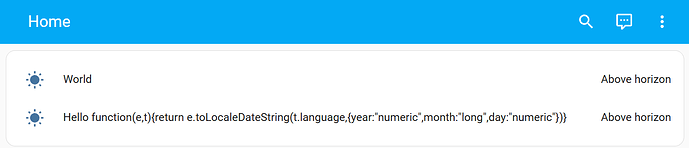

OK - installed 1.37b. different error in view but no error in chrome console:
Stumped.
Full code:
views:
  - title: Home
    type: custom:grid-layout
    cards:
        variables:
          a: |
            const c = "World";
            c;
          b: >
            (passed_var) => {
              const c = "Hello " + a;
              return c;
        entities:
          - sun.sun
        card:
          type: entities
          entities:
            - entity: sun.sun
            - entity: sun.sun

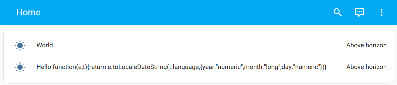

FIXED IT!
reading beta change docs…
Define named variables as variables are parsed
If multiple variables are defined then subsequent variables can
currently reference prior variables using `vars['name']` but not just
`name`.  This enables variables to reference prior variables by name,
like templates can.
So correct code is: vars[‘a’]
b: >
 (passed_var) => {
    const c = "Hello " + vars['a'];
    return c;

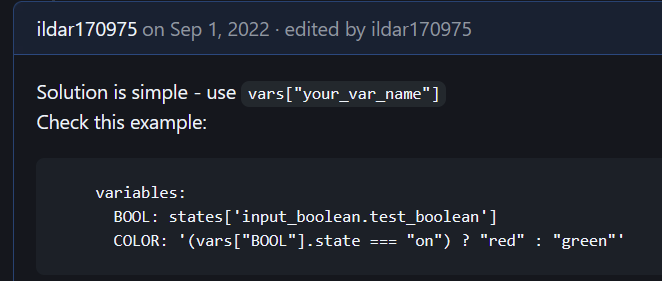

Hmm, if you need to use var_1 inside var_2 - you need to use “vars[‘var_1’]”.
It was described above.
And this is not a NEW thing - check the date:
