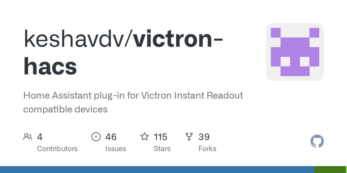

The Victron BMV-712 can be pulled into HA via BT and a custom integration (I have one in my RV).
Pretty plug and play.
