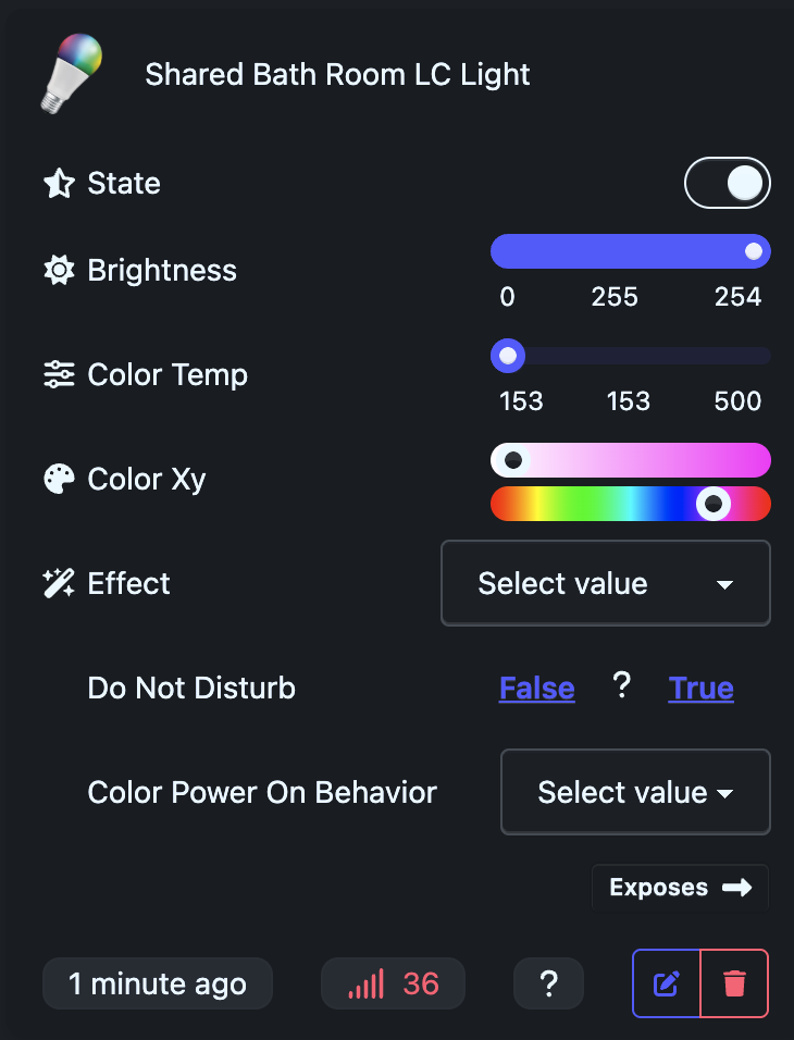

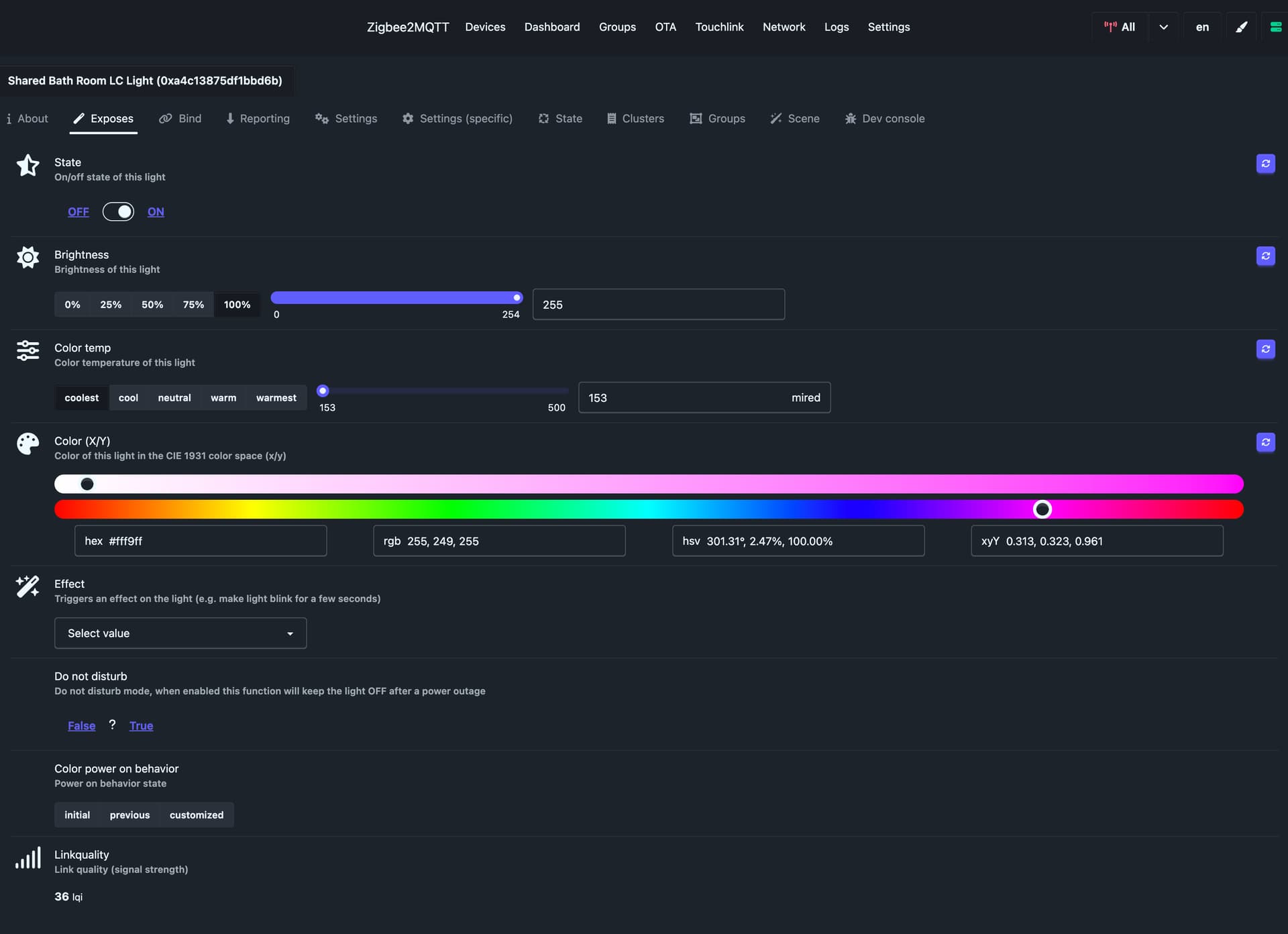

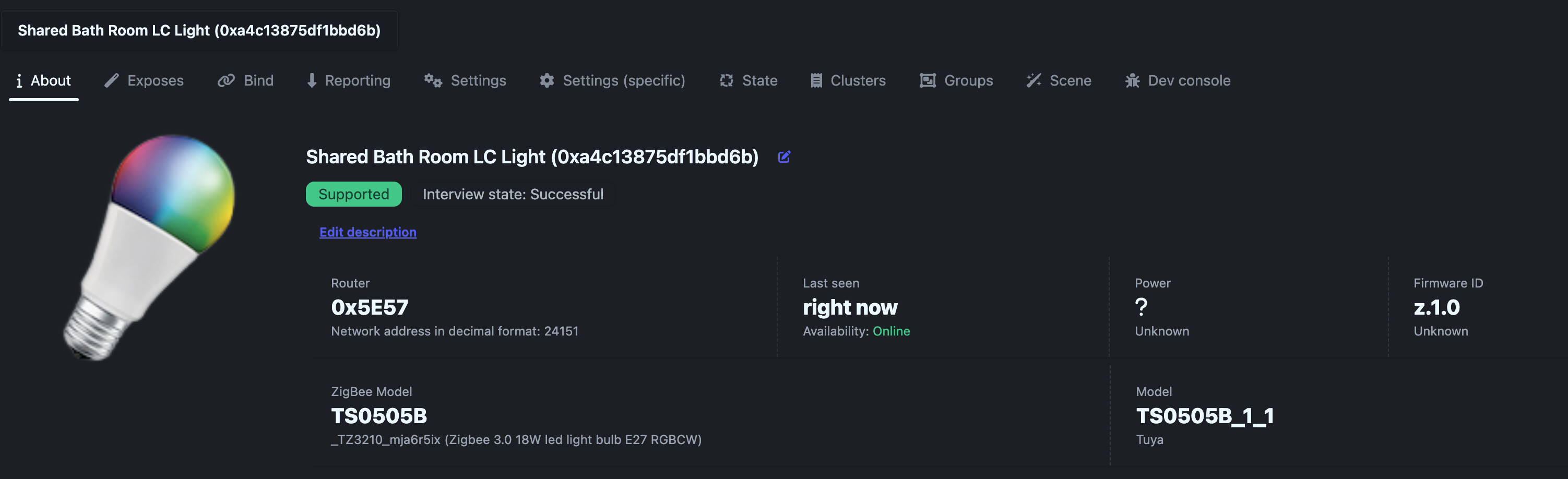

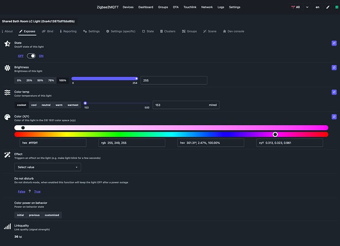

Assuming that you are looking for a E27 type socket bulb. I’m using these with (so far) pretty good longevity, not quite to your power (really lumen) spec I believe. Finding a high lumen ‘smart’ socket bulb has been a challenge, I think heat is a real problem for this form factor. From my experience even the dumb high lumen bulbs die far too soon from heat. Hue makes a high power bulb in this lumen range, however it’s like buying gold. I can get 4 to 5 of these AliExpress bulbs for the price of one Hue, jury is still out on which lasts. I’ve had no failures, either flickering (which I have found to come up on other AliExpress LED devices) or burn out. I started with these bulbs to see if I could use the RGB LED in addition to the WW & CW to create a studio type makeup lighting in bathrooms. However, never found a useful way to control all 5 LED for this, so I just use the WW & CW. Kelvin range is pretty good, low end of dimming is not as good as I would like (bulbs that go really low are a Holy Grail find IMHO). Bulb/fixture orientation seems to be a large factor in life span, heat going up into the electronics (for example a bulb hanging down) seems to reduce life span.
From my experience, if you find a solution via AliExpress type vendors, plan to buy replacements for the long tail. Cause, from my experience … ‘if it’s good, it’s gone’.
