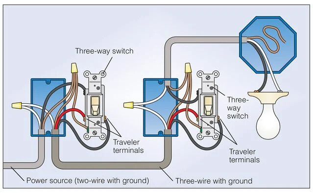

example of how these are usually wired:
Socket F, these are usually not controlled by a switch, just put in the same box with a switch.
I think this would be best…

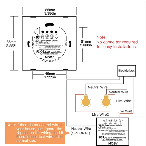

This is the diagram of the MOES switches:
The general idea with the setup is to have the 3rd switch act as a toggle so that it’s always opposite to what the main switch is set hence the common if using a direct smart switch/relay setup that has the option which the t2 does (at the bottom it has SW1, SW2 and COM) you can wire in the 3rd switch to the com port on it and set it up in the settings to control them this way without replacing your current switches fully.
