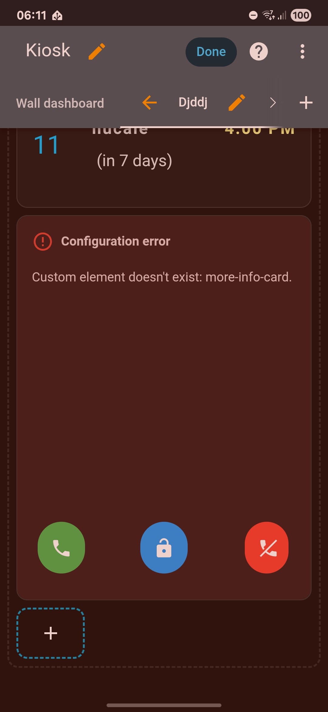

  1. It’s strange to me that the first popup shows an error. It’s just a picture-elements card using the reolink doorbell fluent entity (should use that entity) with some overlay icons.
    What version of browser-mod are you using? It might be that you have an older version?
    The picture-elements card uses a bit of a hack. It sets the image like:
    image: https://upload.wikimedia.org/wikipedia/commons/c/ca/1x1.png
    so it might be conflicting. You can try to “Take control” of the automation and try to put a local image there.
    If that doesn’t work, you can try to remove some other properties of the card
  2. The popup not appearing might be because browser mod is interpreting the different domains (local IP vs NabuCasa URL) as different browsers. You should check that (in the browser-mod tab in HA) when switching the URL.
Just to be clear, the 2 way audio will only work with HTTPS.

you were right about the reason why the pop up didn’t work, I had to register the browser again with the public URL. The 2 way audio is still not working though. With the public address I know see the green dot on the top right of the screen showing a little mic icon with the camera icon. With the local url I had only the camera icon.
About the first pop up error, I still get it. I tried to “take control”, but I’m quite new to this and I don’t see what could be wrong. I saw the line you pasted, but I can’t understand if I need to change the ID somewhere to fix it. I’d post the code but I’m having a hard time to get how to do it properly, to not paste it here as plain text. I’ll try further tomorrow. I’ll let you know

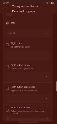

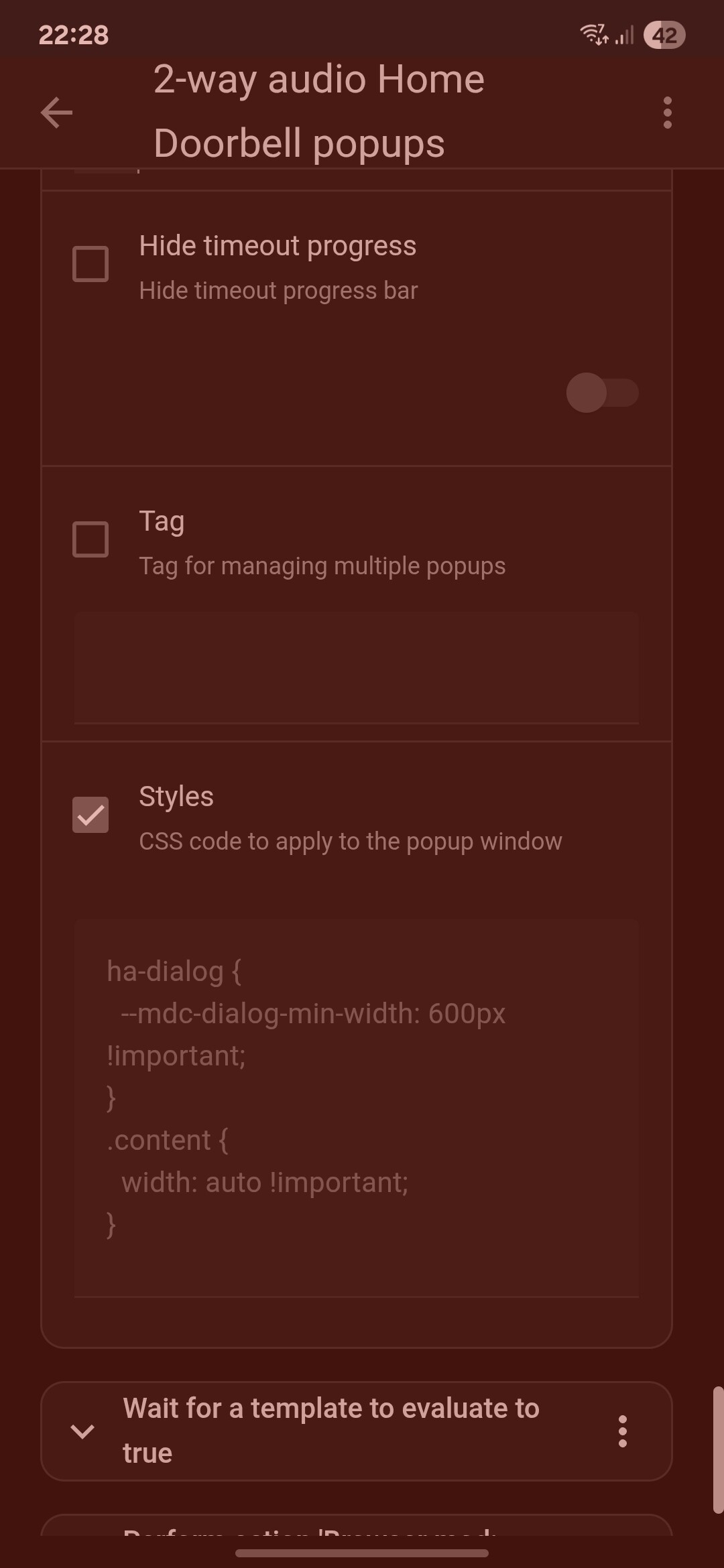

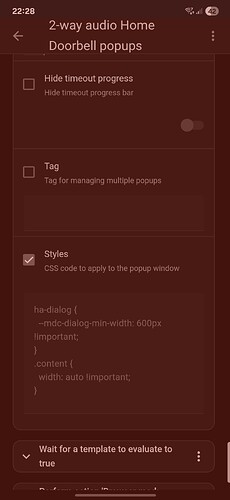

I just copy pasted your code, replaced my browser- mod browser, visitor and camera fluent entities and it works good. I can see the video feed in the first popup without any error.
I would say it’s a problem with browser mod. Can you paste a screenshot of the Perform an action: Browser mod popup action’s top content? Where you select the browser.
I’m not really sure I understand what you’re telling me to do, but these are the screenshots of that part of the automation with some features selected and the code

Can you try to create a card in the dasboard with the following content and see if it works?

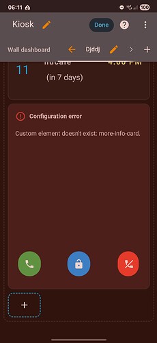

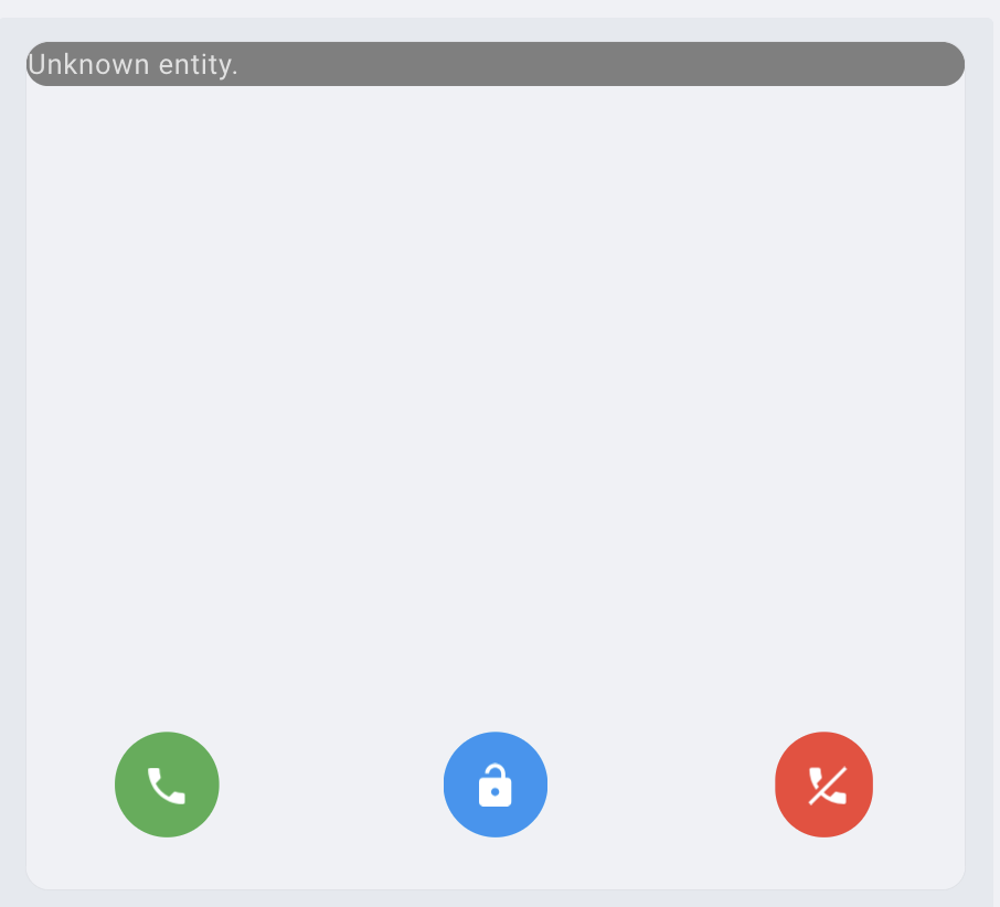

I just tried this exact content, with your entities, and I see the card showing without the “Configuration error”:
I got the error here too
Oh the error is obvious, you skipped the 5th requirement of the guide. The more-info-card is not installed.
That’s it! Now it’s fixed! Thank you…

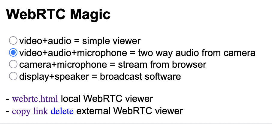

If you are able to see the stream in the second popup and you hear the audio but the microphone is not working it can be because of 2 things:
  • you are not using HTTPS
  • your go2rtc config is incorrect
If you can’t even see the video in the second popup, it’s definetly something between the doorbell or the recorder and go2rtc. I can’t help with that because I connect to the doorbell directly.
You can try to debug it using the go2rtc addon.
  1. Open the web interface:
    Open your Home Assistant instance and open the ingress URL of an add-on.
  2. Click on the links anchor under the Commands column in your stream row
  3. At the bottom of the page, you will see a section called “WebRTC Magic”. Select the video+audio+microphone option and you can test both local and exteral players opening the webrtc.html (for local) and copy link and paste it in another tab (for external).
If anything is not working, then the problem is in your go2rtc configuration. Because maybe as you mentioned you are using the RTSP stream from your recorder instead of the camera itself.
