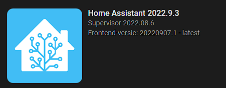

I do not have this problem (blank settings page) with 2022.9.3 on x86-64 supervised.
Have you updated the frontend part?
Screenshot 2022-09-14 081659
blank settings page - 2022.9.3 on x86-64 supervised.
My frontend is Frontend 20220907.1 - latest and I see everything I should.
OK I am stoopid and wasn’t clicking on the right page, I have this problem too. Sorry for the noise. Given a fix is in the offing, no further comment.

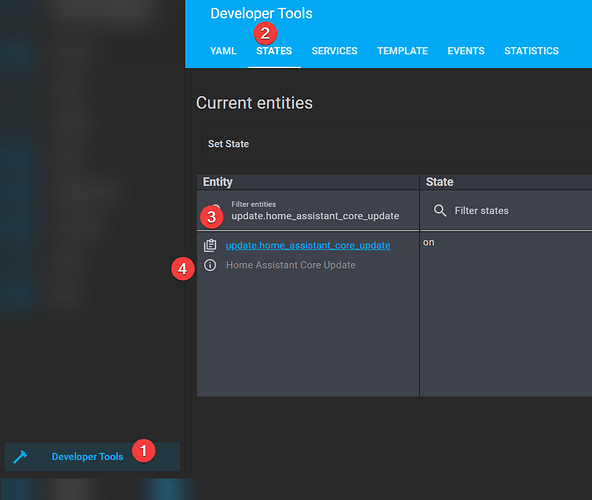

For those who are confused how to update without the “Settings”-page, run from the CLI:
ha core update --version 2022.9.4
Or you can use the update button through the developer tools → states page by searching for update.home_assistant_core_update.
Or clicking the search button on your main dashboard and find update.home_assistant_core_update.

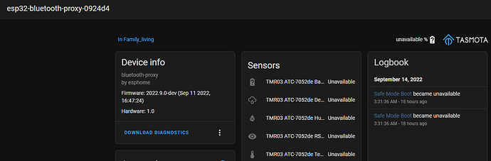

I’m creating Bluetooth proxies for my Xiaomi temp/hum sensors running the latest ATC firmware but find this strange page. I am repurposing old ESP32s that ran Tasmota before. The whole process via the new Bluetooth proxy provisioning page completes but then I get this. I thought the device is wiped?
brand new ESP32s look like this which is what you’d expect. Looks like both ESPs are running the same firmware
How can I connect to these BT proxies (I can connect and check the log file when they are being provisioned but not when they are out there)?
While we are on this what does Safe Mode Boot do?
