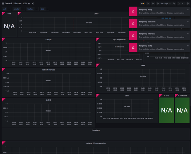

@sender, and now as you have that glances influxdb datasource set up in the Grafana, if you import the dashboard again, can you select the Glances datasource from the list and it still gives those red errors “! database name required”?
Yes indeed like that… :frowning:
@sender, let’s check if you actually can see the data from InfluxDB in Grafana.
Make new empty dashboard with empty panel in Grafana
And then make an query to glances -datasource like “from” localhost.load, “select” field(min15):
Do you see the graph popping up?
