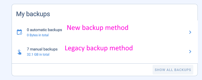

But when I will upgrade an integartion or HA, the Automatic backup will use the new HA backup system (with mandatory encryption)?
No. That is new and in addition to the legacy backup system that you are using now. Just keep using your backup method it will continue to function.

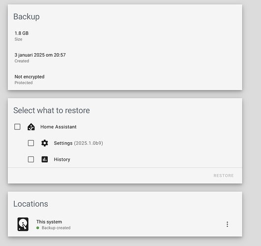

doing something like that too, hitting the backup button to break out of the automatic system.
I wonder though if you see the same as I do here:
the manual backups in my folder
dont have the add-ons backed up:
like the automatic backups do:
the manual backups in this screen are created by clicking the update button in the tile card confirmation upon updating, which is still available and offering user choice

Yes all my manual backups created by SAMBA backup are full backups:
And I confirmed earlier today that doing a partial restore of one add-on (zigbee2mqtt) worked as expected.
right. that would mean those type of manual backups are not the same…
So you are saying a full manual backup using the new system does not backup add-ons?

yes, when clicking this download button (meaning yes I want to update)
a confirmation shows asking whether you want to backup before updating. clicking yes there produces the backups I showed above.
maybe they’re not called manual backups, but no, they don’t include the add-ons
