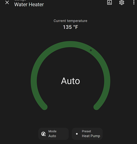

I have an Econet-based heatpump water heater, and I’ve been successfully controlling it with the esphome-econet integration. It only has two operating modes, “Off” and “Auto”. With the 2025.10 update, in “Auto” mode, I can’t set the temperature:
I have to set the mode to “Off”, before the temperature slider comes back and I can then set the temperature. Am I doing something wrong, is the integration doing something wrong, or is there a bug in the thermostat card?

Just to close the loop here, I discovered that the esphome-econet folks have fixed this problem in their component. I also do not agree with this reduction in features in the “Auto” mode, but at least for the water heater issue for me, it’s been solved.
