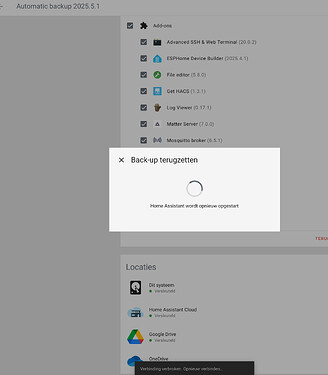

Tried to get Better, didnt work out. tried to restore this mornings backup:

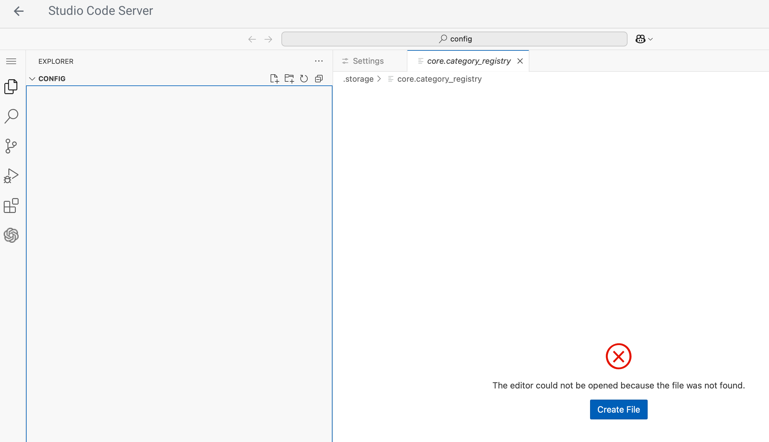

complete /config folder got wiped… while in the Dashboard, an eery experience.
managed to get to the system menu items (my own yaml config is gone) and trying to restore once again, but this remains in view…
o dear
can we somehow check if this is actually active, or hanging?

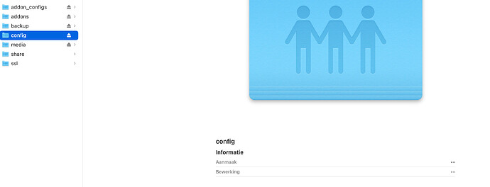

I managed to pull of a ha core start in the Terminal, and got a working Frontend. However, still non files in the /config ???:
and whopper, gone is the Dashboard again.

was able somehow to restart via the Terminal (HA interface wouldnt let me because of ‘no configuration.yaml’ that meanwhile had been set back manually…)
