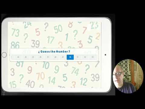

As expected, your script proved to be a good base for adding this to View Assist. It is still really rough around the edges but check out the video anyway :D. Turn on sound.
View Assist provides visual feedback to HA Assist.
