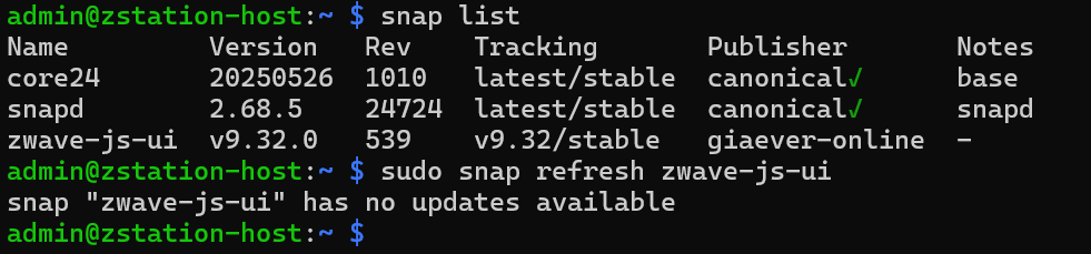

After the update i see this issue with Z wave
Failed setup, will retry: Invalid server version: Z-Wave JS Server version (1.40.3) is incompatible. Update the Z-Wave JS Server to a version that supports at least api schema 41
I’m running JS Server on a snap container

Thank you, @mhoogenbosch any idea on how to update it?

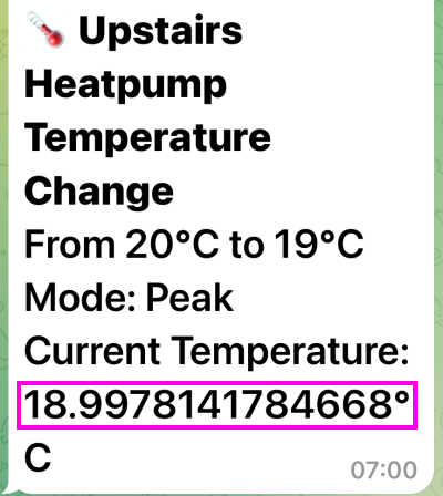

Might have a bug here. Previously, numeric entities with a lot of random decimals seemed to be auto-truncated based on the display precision in templates and such. They’re not in 2025.7, resulting in some very long numbers in templates. These are coming from ESPHome devices running a mix of versions. What’s interesting to me is that this is happening on some devices that are explicitly setting accuracy_decimals: 1, but yet in HASS 2025.7 they’re showing up with 10+ decimal places.
Nope, don’t even know what snap is :sweat_smile:. Maybe there is an index update command? Similar to apt get update?
That was intentional: Implement suggested_display_precision for ESPHome by jesserockz ¡ Pull Request #147849 ¡ home-assistant/core ¡ GitHub
In 2025.6 - accuracy_decimals sets the entity’s state.
In 2025.7 - accuracy_decimals sets the entity’s suggested_display_precision
However if you’re using a custom card or template that does not respect the display_precision, you’ll see the raw state with all it’s extra decimals.
Display_precision has never affected the output of templates.
Yep it’s all custom cards (and MagicMirror templates), thanks for pointing that out - time to go make some tweaks.

I’m using esphome sensors that are now displaying ridiculous numbers of decimal places in my telegram messages (so a template). Do I have to update all my message templates to include a round filter or can this be fixed in one place (e.g. esphome)?
example message:
  - continue_on_error: true
    action: notify.telegram_system_log
      title: "🌡️ <b>Upstairs Heatpump Temperature Change</b>"
      message: >
        From {{ trigger.from_state.state }}°C to {{ trigger.to_state.state }}°C
        Mode: {{ states('sensor.upstairs_climate_mode') }}
        Current Temperature: {{ states('sensor.lounge_room_temperature') }}°C
