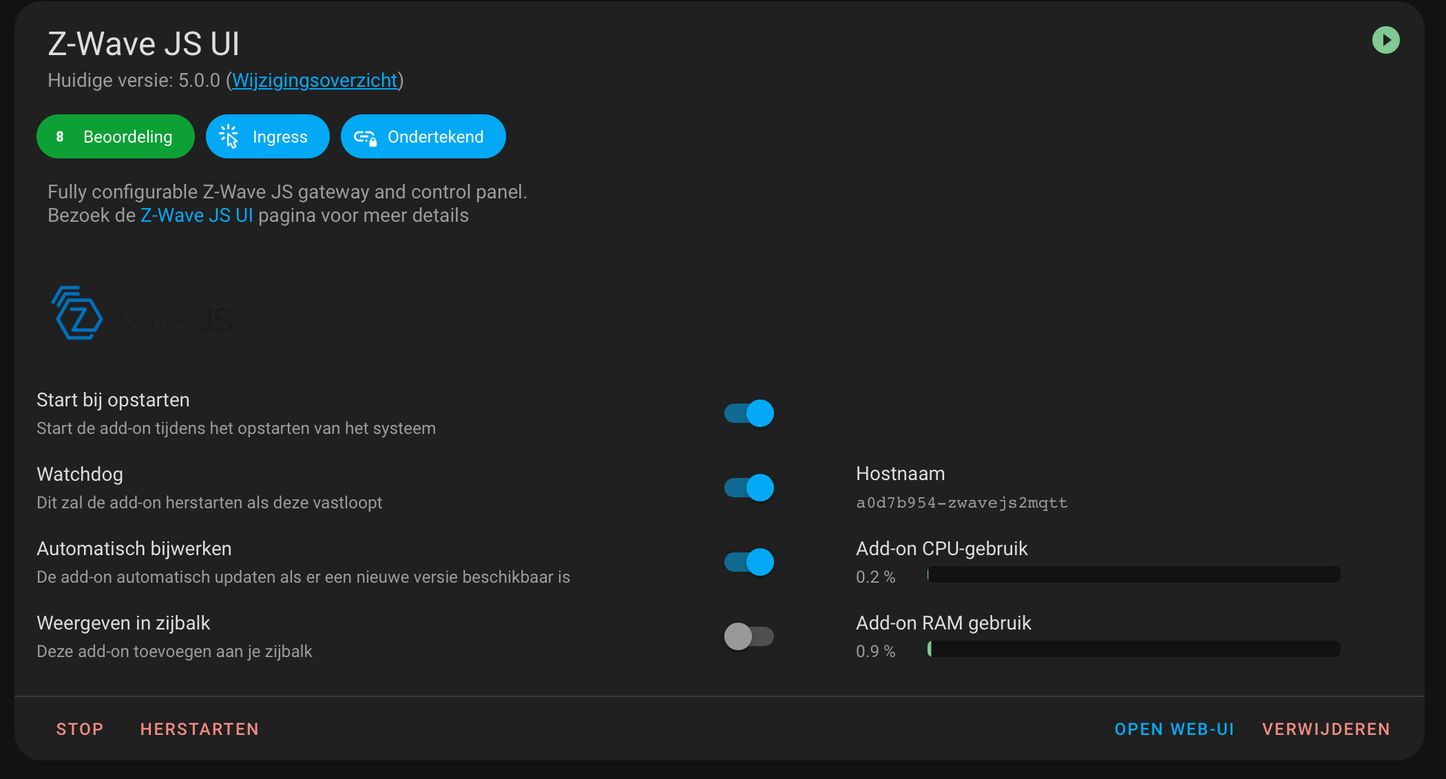

And what does the addon version say?

Are you sure you don’t mean Home Assistant Operating System ( HAOS)? I didn’t think you could run add-ons in Core.
Z-Wave JS
Failed setup, will retry: Invalid server version: Z-Wave JS Server version (3.0.2) is incompatible. Update the Z-Wave JS Server to a version that supports at least api schema 44
