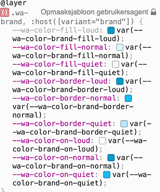

Now… How does that work on overriding?
I’m not able to find any documentation on the :host([***]) part, or in the CSS docs?
Why is --color-primary-** hardcoded in true hex-color-codes? Why don’t use 1 primary-color and use HSL to do the variants and mix with more or less shades and shifting of white/black?

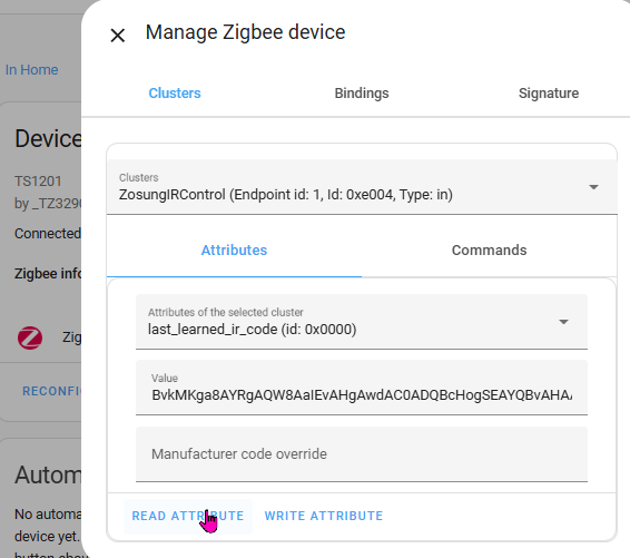

FYI, 2025.8.0b1 breaks my zigbee IR blaster. It’s effectively a ZS05 with custom quirk as per Tuya Zigbee Infrared Blaster ZS05 Review - SmartHomeScene
With the beta version installed, it doesn’t respond to reading ‘last learned code’ attribute from the device. Rolled back to 2025.7.3 and it works again.
EG: doing this returns no value (value shown when running 2025.7.3)
Unsure if the same applies with other zigbee devices.
yes. as per my above post + now you mention it the buttons on my zigbee switch to open/close blinds failed to work.
i’ve since rolled back to 2025.7.3 and its all good again.

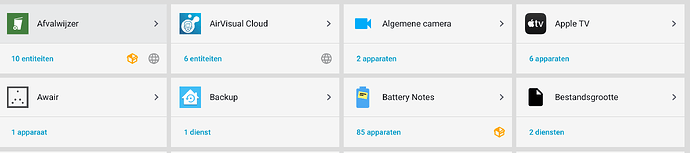

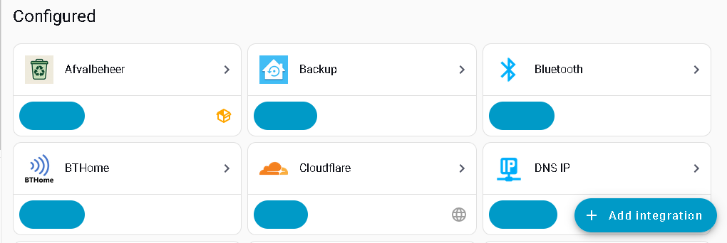

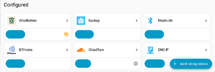

2025.8.0b2 has a strange integrations screen

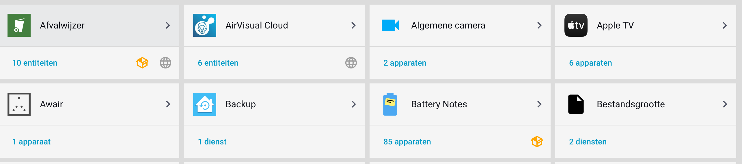

you sure you refreshed cache, this is what I am seeing

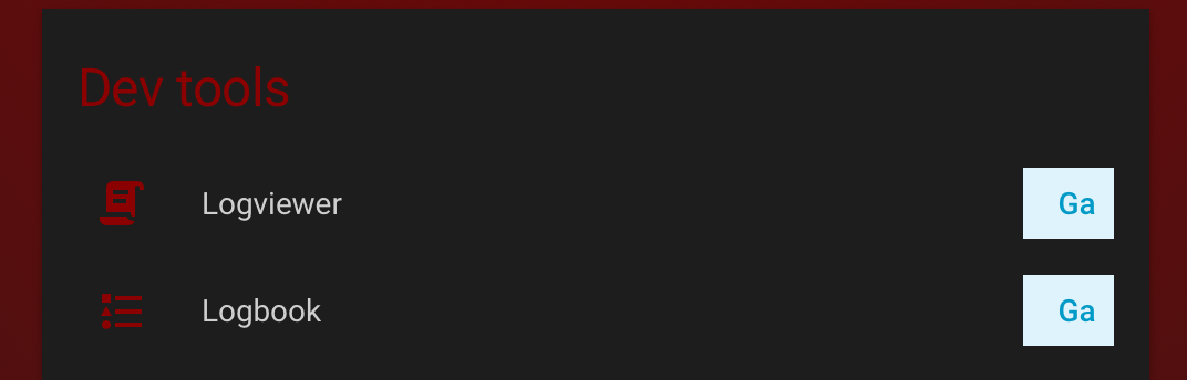

however, you’re bringing up a valid point: the new (button) theming in the color variables. the consequences are huge.
Unless you only use default theme. Personally I have 4 main themes that are used in various states of the home, and depending on sun up or down.
in the current state of affairs, those bright blue buttons show in all of my themes. 1 example
Upon request, Wendelin was kind enough to add some text in the resource file, but that doesnt really help us to fix our themes.

Picture coming from Firefox in incognito window, so cache should not be a problem.
ctrl-F5 does not help
Odd, this is supposed to be fixed (.0 suffered this) so if you really updated to .2 now and still see it I guess you should add that to the closed issue
Are you running the default theme?
