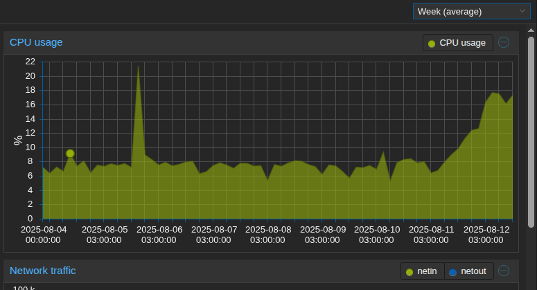

Hello, I’m having same issue with latest version, i’m running it on a proxmox setup running ha os, cpu usage clearly increased since i upgraded to the latest ha versions. :frowning:

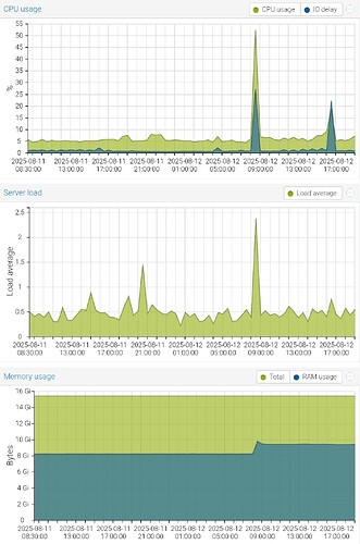

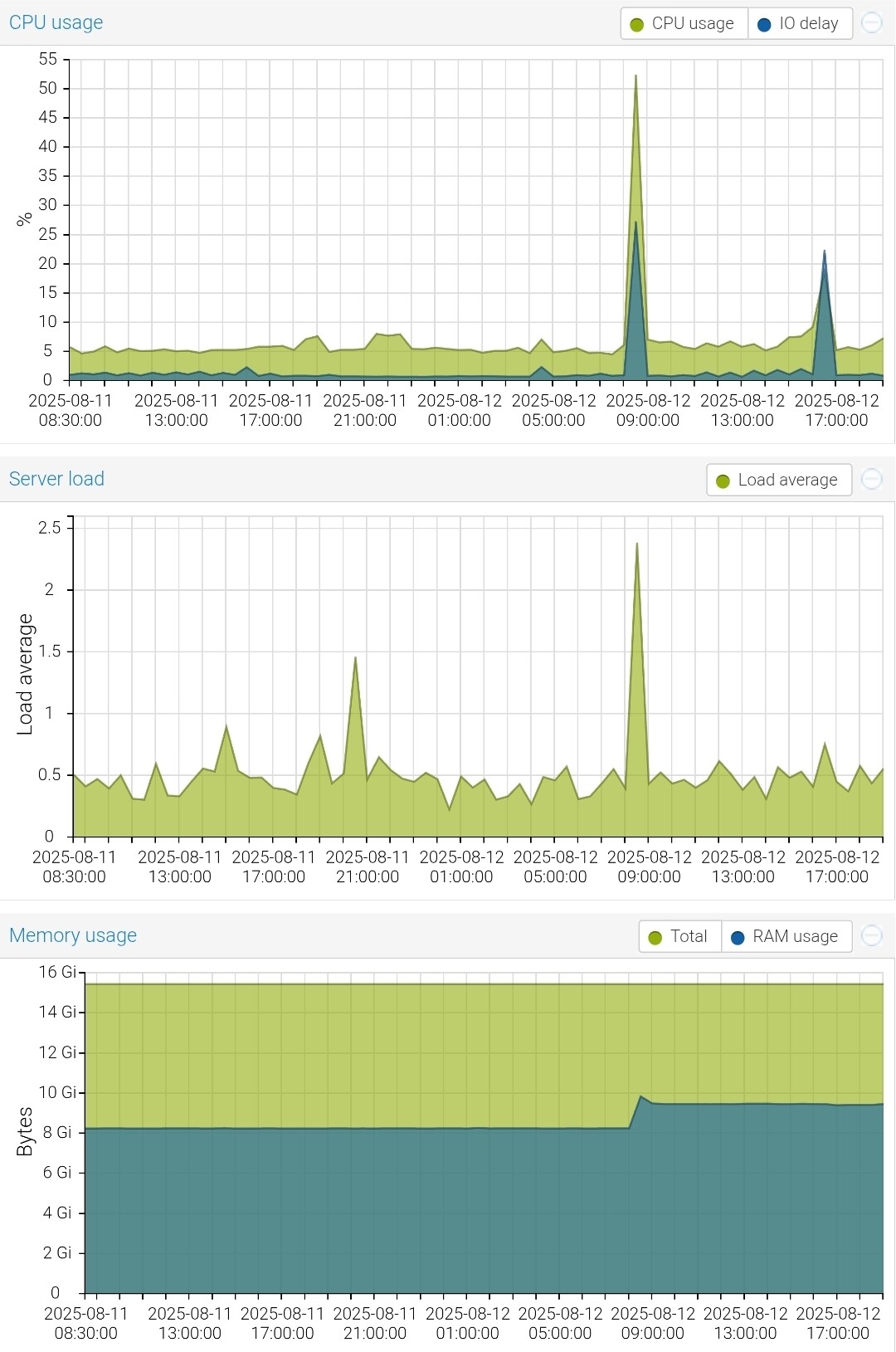

No CPU usage increase for me after the upgrade to 2025.8.1. (upgrade was done around 9:00).
Only the memory usage increases a bit but maybe that will be gone after a restart.
