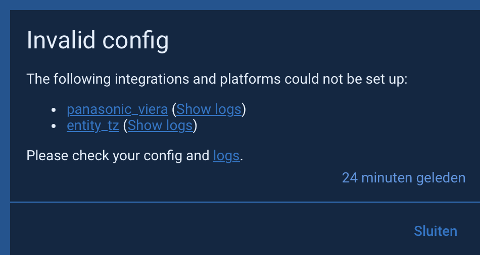

Also broken Panasonic Viera now (2025.9.3) and Custom integration Entity_tz
Log
Logger: homeassistant.setup
Bron: setup.py:343
Eerst voorgekomen: 23:16:23 (2 gebeurtenissen)
Laatst gelogd: 23:16:38
Setup failed for ‘panasonic_viera’: Unable to import component: Exception importing homeassistant.components.panasonic_viera
Setup failed for custom integration ‘entity_tz’: Unable to import component: Exception importing custom_components.entity_tz
File “/usr/src/homeassistant/homeassistant/loader.py”, line 1063, in _get_component
ComponentProtocol, importlib.import_module(self.pkg_path)
File “/usr/src/homeassistant/homeassistant/util/loop.py”, line 201, in protected_loop_func
return func(*args, **kwargs)
File “/usr/local/lib/python3.13/importlib/init.py”, line 88, in import_module
return _bootstrap._gcd_import(name[level:], package, level)
File “”, line 1387, in _gcd_import
File “”, line 1360, in _find_and_load
File “”, line 1331, in _find_and_load_unlocked
File “”, line 935, in _load_unlocked
File “”, line 1026, in exec_module
File “”, line 488, in _call_with_frames_removed
File “/usr/src/homeassistant/homeassistant/components/panasonic_viera/init.py”, line 9, in
from panasonic_viera import EncryptionRequired, Keys, RemoteControl, SOAPError
File “/usr/local/lib/python3.13/site-packages/panasonic_viera/init.py”, line 16, in
from Crypto.Cipher import AES
File “/usr/local/lib/python3.13/site-packages/Crypto/Cipher/AES.py”, line 26, in
from Crypto.Util._raw_api import (load_pycryptodome_raw_lib,
VoidPointer, SmartPointer,
c_size_t, c_uint8_ptr)
File “/usr/local/lib/python3.13/site-packages/Crypto/Util/_raw_api.py”, line 87, in
ffi = FFI()
File “/usr/local/lib/python3.13/site-packages/cffi/api.py”, line 54, in init
raise Exception(“Version mismatch: this is the ‘cffi’ package version %s, located in %r. When we import the top-level ‘_cffi_backend’ extension module, we get version %s, located in %r. The two versions should be equal; check your installation.” % (
version, file,
backend.version, backend.file))
Exception: Version mismatch: this is the ‘cffi’ package version 1.17.1, located in ‘/usr/local/lib/python3.13/site-packages/cffi/api.py’. When we import the top-level ‘_cffi_backend’ extension module, we get version 2.0.0, located in ‘/usr/local/lib/python3.13/site-packages/_cffi_backend.cpython-313-x86_64-linux-musl.so’. The two versions should be equal; check your installation.
File “/usr/src/homeassistant/homeassistant/loader.py”, line 1003, in async_get_component
comp = await self.hass.async_add_import_executor_job(
self._get_component, True
File “/usr/local/lib/python3.13/concurrent/futures/thread.py”, line 59, in run
File “/usr/src/homeassistant/homeassistant/loader.py”, line 1074, in _get_component
raise ImportError(f"Exception importing {self.pkg_path}") from err
ImportError: Exception importing homeassistant.components.panasonic_viera
ffi = FFI()
version, file,
File “/usr/src/homeassistant/homeassistant/setup.py”, line 343, in _async_setup_component
component = await integration.async_get_component()
File “/usr/src/homeassistant/homeassistant/loader.py”, line 1023, in async_get_component
self._component_future.result()
File “/usr/src/homeassistant/homeassistant/loader.py”, line 1015, in async_get_component
comp = self._get_component()
leading to;

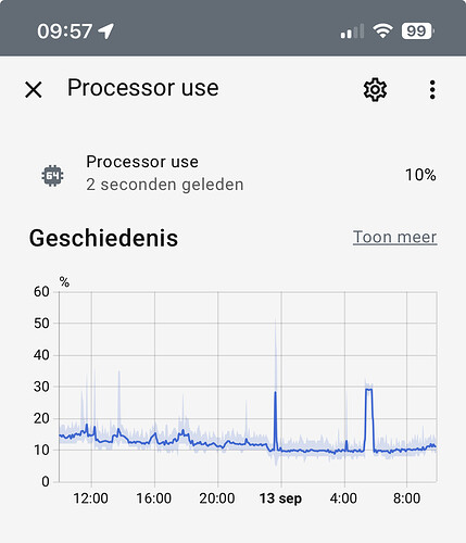

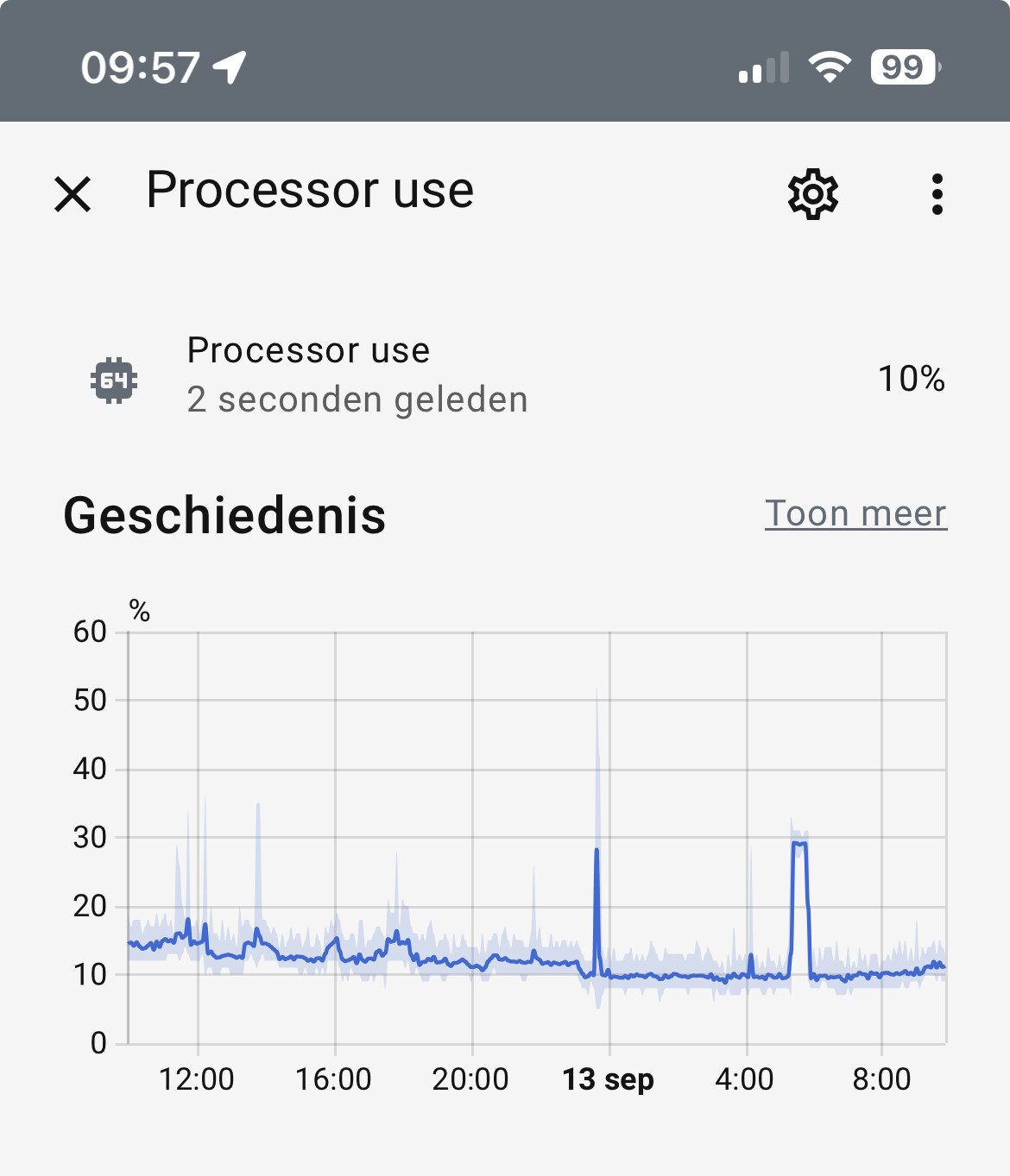

Looking back through my CPU usage history I’d say the general average has gone up about 15~20% on an i7 NUC since installing HA 2025.9.x (currently on 2025.9.3) vs 2025.8.x.
Confirmed 2025.9.3 has resolved the processor utilisation issue for me, HA Yellow with CM4 :slightly_smiling_face:
2025.9.3 has restored normal utilisation level on my system. HA Yellow with CM4.

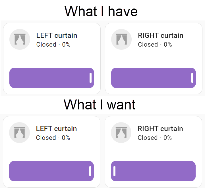

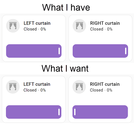

Please add a feature to make a reversed slider
